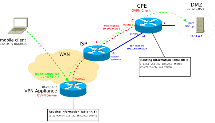

Hi *,
I’m attaching a sketch of a problem that I believe is related to policy based routing.
Whenever the mobile client tries to access the web server located in the DMZ behind the CPE using the port forwarding (DNAT) through the vpn appliance, traffic goes through.
However, since the mobile client’s is connecting using a publicly routed ip address, the CPE (RB2011) forwards reply traffic using its default gateway instead of the vpn interface.
How can ensure that reply traffic leaves through interface ovpnc1 which is the one it initially arrived on?
Thanks in advance

Well, yes, it would help with this but from my understanding placing a routing mark as with your post will basically match all traffic that’s coming from the DMZ subnet. But the hosts in the DMZ should still be able to communicate to the outside w/o having all outbound traffic routed via the VPN by default. In fact the VPN only carries inbound but no outbound traffic.
I also wonder if it wouldn’t make sense to implement this using >ip route rules instead which would classify traffic based on the IP layer only. Guess it would be much faster compared to placing a routing mark using iptables (netfilter) running mangle. However, it gives you more fine-grained control when pushing traffic into a separate routing table based on certain constraints like the transport protocol or the used communication port.
This should be quite easy using two mangle rules.
Create a first rule that marks connections coming from the VPN tunnel and not having a mark already.
Create a second rule that applies a new routing mark to packets marked with the connection mark and coming from the DMZ.
Add a new routing table with the routing mark and route via VPN.
This works because when marking a connection the router will automatically give that mark to response packets too.

Well, in my lab I came up with the following but somehow it still doesn’t work.
When both mangle rules are enabled inbound traffic via vpn does no longer reach the host located in the DMZ.

Well, take a look again at what I said:
Create a second rule that applies a new routing mark to packets marked with the connection mark > and coming from the DMZ.
Right now you are switching inbound traffic to a routing table that no longer has the destination it is supposed to reach.
Got you, it’s working perfectly fine now, thanks!
