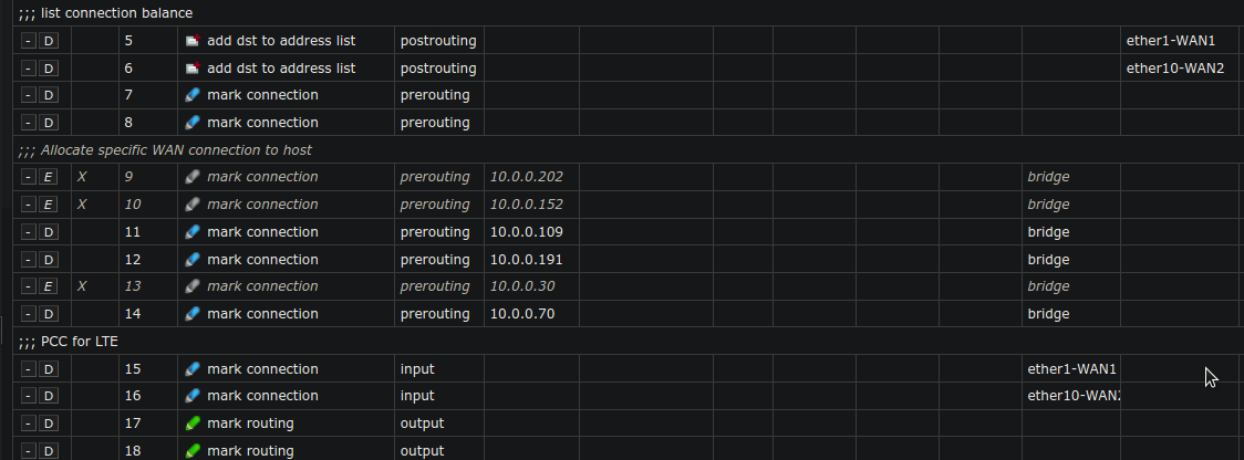

/ip firewall mangle
add action=add-dst-to-address-list address-list=use-WAN1 address-list-timeout=1h chain=postrouting comment="list connection balance" out-interface=ether1-WAN1
add action=add-dst-to-address-list address-list=use-WAN2 address-list-timeout=1h chain=postrouting out-interface=ether10-WAN2
add action=mark-connection chain=prerouting dst-address-list=use-WAN1 new-connection-mark=WAN1_conn passthrough=yes
add action=mark-connection chain=prerouting dst-address-list=use-WAN2 new-connection-mark=WAN2_conn passthrough=yes
I’ll try to reboot the router tonight, I’ll let you know in the morning if it’s working properly.
Thanks, Sindy.
sindy, thanks again,
everything works properly, practically the traffic is sorted a bit on one gateway a bit on the other keeping the routes for an hour.

I enclose here below my final working configuration.
mybackup.rsc (12.5 KB)

@anav,
  1. those rules (some are disabled) are pecedent to those of PCC and are used to direct the traffic of some devices with fixed ip (managed by dhcp server) exclusively to a specific WAN.
  2. I didn’t understand your problem with dynamic ip’s.
    ---- In dhcp server I reserved static addresses for some devices .
---- the first two rules you see make sure that some services (grouped in list-address) such as speed test , are processed in postrouting and thus do not suffer from any slowdowns .
---- the third and fourth regenerate lists to instard traffic , so that some sites (such as banks ) are always connected from the same WAN
---- the fifth and sixth is prerouting the WANs .
