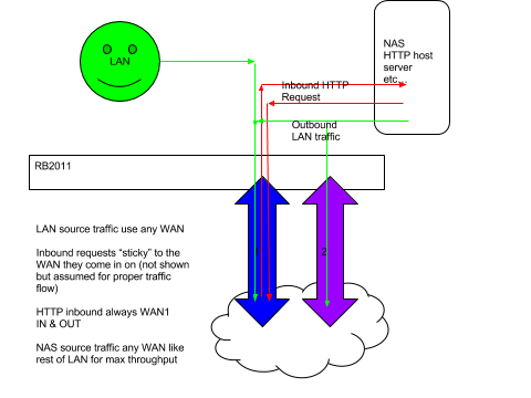

An update to all this, that I am still working out bugs and issues an really have been trying to put the final grasp on some of these configuration options.
I’m going to post a small book here an hope that someone can turn on my lightbulb an get me on my way.
When having to deal with Mangle chains I am stumped on the reason for each chain choice can someone please lay this out for me.
The Wiki is rather vague:
chain (name; Default: ) Specifies to which chain rule will be added. If the input does not match the name of an already defined chain, a new chain will be created.

Now I’m trying to get my hairpin to work properly.
The rule that I was using without issue prior to the 2nd WAN connection isn’t working.
add chain=srcnat src-address=192.168.1.0/24 \
  dst-address=192.168.1.xxx protocol=tcp dst-port=80 \
  out-interface=LAN action=masquerade
I feel this has to do with the opening accept rule that I can’t properly apply in my mangle since I don’t have static ip’s I can apply like in the examples people use.
I do however have the accept rule for traffic sourced/destined for my network.
chain=prerouting action=accept src-address-list=LAN dst-address-list=LAN
When I attempt to load my website by name internally my browsers status bar flips a couple of times showing the url/not/showing/not an then times out. this takes roughly 3 seconds or so.
Any ideas?

I still haven’t figured out my hairpin though. I used to be able to just www.address.com and it would come up just as if I had pulled it up “local” but it just times out now.
Any variation I do to the old hairpin NAT rule has made no difference.
Have you tried NOT specifying a out interface on your masquerade rule. With mine now set with no out interface things work pretty fast. Will update if there are any problems.
No change.
 chain=srcnat action=masquerade protocol=tcp src-address=192.168.1.0/24 dst-address=192.168.1.xxx dst-port=80
Still get the momentary “Looking for…” “Connecting to…” an time out.
I see no counters hit either in the inbound WAN dst-nat or the internal hairpin rule.
No src ip, no dst ip, no port
