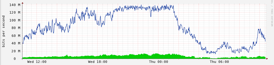

I have a CCR1036-12G-4S on v6.2 (has also been on 6.0 RC 12 as well as v6.1). I am using the PCC method of load balancing with src address being the Per Connection Classifier.
It can currently only do near 135-140Mbps simultaneously on both connections at once (so 67-70Mbps on each connection). I have tested each connection and they both can do 100Mbps+ individually. If I disable one of them it will do 100Mbps easily.
This is not my first time using the PCC method, however it is my first time using it with this much bandwidth. Maybe I missed a setting somewhere, does anyone have any idea? I attached the export and a quick snapshot of the cacti graph.

v6.3 made some changes in a positive way to CCR’s … v6.4 came out today. Try that and see if it still has the same behavior.
same performance on v6.3 and v6.4
I have gone through the config multiple times, cannot find an error.
Anyone else run into this?
i have the same problemi have the same problem i can/t get more than 100Mbps i have x2 200Mbps routers and bothe have 200 when i test without mikrotik board
try with “both addresses and ports” in pcc rules. but this will break https sites.
me always using “both addresses” only.
