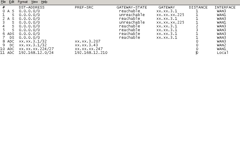

please post your routing table
My Routing table:
WAN1 is not connected
DST-ADDRESS PREF-SRC GATEWAY-STATE GATEWAY DISTANCE INTERFACE
0 A S 0.0.0.0/0 reachable xx.xx.3.1 1 WAN3
1 S 0.0.0.0/0 unreachable xx.xx.xx.225 1 WAN1
2 A S 0.0.0.0/0 reachable xx.xx.3.1 1 WAN3
3 S 0.0.0.0/0 unreachable xx.xx.xx.225 1 WAN1
4 S 0.0.0.0/0 reachable xx.xx.3.1 2 WAN3
5 S 0.0.0.0/0 reachable xx.xx.3.1 3 WAN3
6 ADS 0.0.0.0/0 reachable xx.xx.3.1 1 WAN3
7 DS 0.0.0.0/0 reachable xx.xx.3.1 1 WAN3
8 ADC xx.xx.3.1/32 xx.xx.3.207 0 WAN3
9 DC xx.xx.3.1/32 xx.xx.3.43 0 WAN2
10 ADC xx.xx.xx.224/27 xx.xx.xx.247 0 WAN1
11 ADC 192.168.12.0/24 192.168.12.210 0 Local
Thanks for your help.

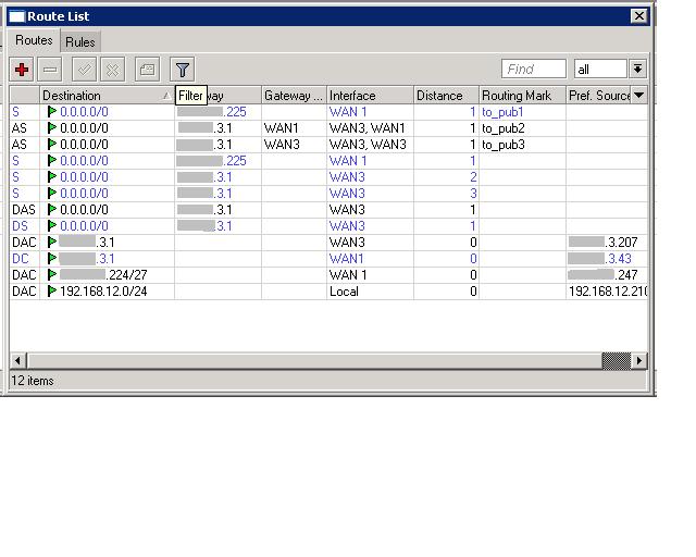

Sorry. this one has a nicer view :slight_smile:
so, as you can see, all your default routes goes through WAN3 =)

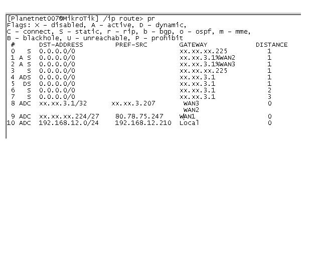

to the topic: install ‘routing-test’ package. when adding routes via terminal use ‘gateway=xx.xx.xx.225%WAN1’ and ‘gateway=xx.xx.xx.225%WAN2’
Maybe when adding routes via terminal must use ‘gateway=xx.xx.3.1%WAN2’ and ‘gateway=xx.xx..3.1%WAN3’
not ‘gateway=xx.xx.xx.225%WAN1’ and ‘gateway=xx.xx.xx.225%WAN2’ ???
Because WAN2 & WAN3 have the same GW IP address.
I did it in this way (‘gateway=xx.xx.3.1%WAN2’ and ‘gateway=xx.xx..3.1%WAN3’) and I have this routing table.
Viewing from the eyes of an expert, of you, is this OK?
thank you again for your help.
seems okay, so… just test it =)
I test it and it is really well working.

My Router's actual config is:
[admin@MikroTik] > ip route print
DST-ADDRESS PREF-SRC GATEWAY DISTANCE
0 S 0.0.0.0/0 xx.xx.xx.225 1
1 A S 0.0.0.0/0 xx.xx.3.1%WAN2 1
2 A S 0.0.0.0/0 xx.xx.3.1%WAN3 1
3 ADS 0.0.0.0/0 xx.xx.3.1 1
4 S 0.0.0.0/0 xx.xx.xx.225 1
5 DS 0.0.0.0/0 xx.xx.3.1 1
6 S 0.0.0.0/0 xx.xx.3.1 2
7 S 0.0.0.0/0 xx.xx.3.1 3
8 ADC xx.xx.3.1/32 xx.xx.3.207 WAN3 0
WAN2
9 ADC xx.xx.xx.224/27 xx.xx.xx.247 WAN1 0
10 ADC 192.168.12.0/24 192.168.12.210 Local
