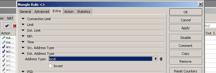

  1. base on manual between winbox configuration as the example of pcc wiki there is exclamatory point in dst-address-type but in winbox gui box name invert box is this the same as pcc manual?

yes, you are correct.
