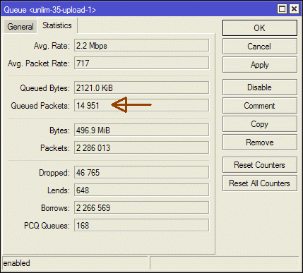

we’re using v5.4 for now, and sometimes our PCQ queue shows erratic behaviour. that’s my queue type:
add kind=pcq name=unlim-35-upload pcq-classifier=src-address \
    pcq-rate=512k pcq-limit=256 pcq-total-limit=65536

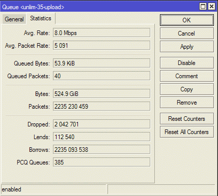

and here’s normal queue work:

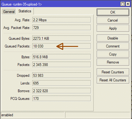

sometimes (I think, some computers are flooding with big number of packets) number of queued packets extremely increases:
during this time, every user that passes the queue has high RTT and packet loss, even with very low traffic
is it known problem of 5.4, were there any fixes regarding PCQ in later versions?..

as for my problem, PCQ is designed to divide bandwidth equally (according to its description), so it should work like many PFIFO queues of ‘limit’ size. during trouble times, I see that subqueues with almost no traffic are… kind of ‘congested’?.. and other PCQ queues works normally. also, the number of queued packets increased from 15000 to 18000 just in real time, in about 15-20 seconds. I have only two screenshots, but in reality it was increasing, increasing, increasing…
for me, it looks like a bug in PCQ implementation, because I don’t believe that all users together began to flood packets. btw, I have Max-Limit set to 40M for that queue, so even 2MiB of queued data should not be a problem
