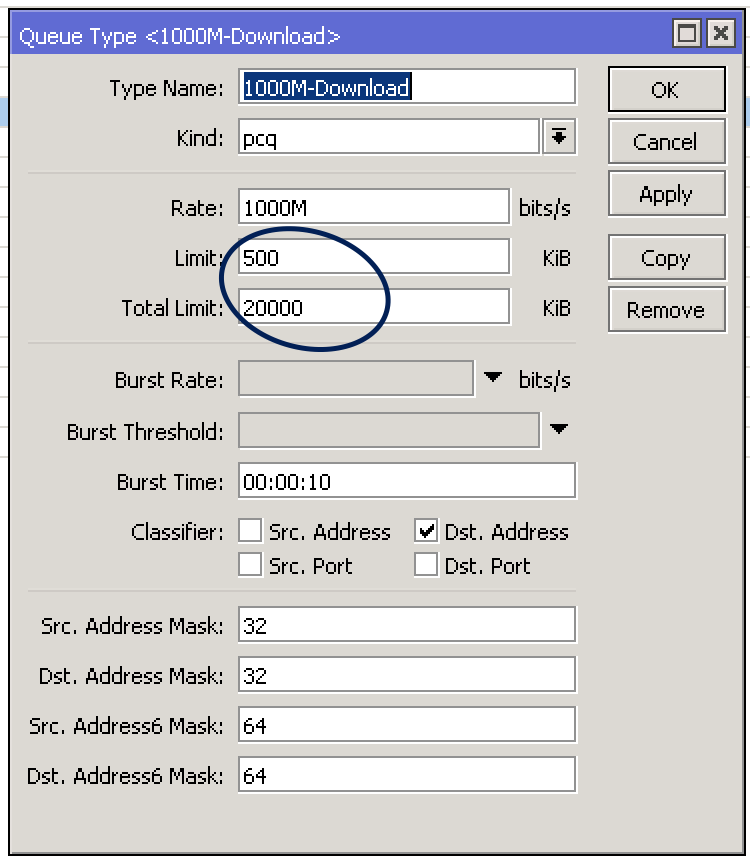

tatal-limit= limit*
400 client, and limit=50 —> total-limit=20000
More info on limit (or queue size) is here:
http://wiki.mikrotik.com/wiki/Queue_Size
tatal-limit= limit*

OK, I get how Limit and Total-Limit works, but I have one question.
Are the limits calculated for each queue (simple/tree) or for whole type?
I mean, If I will create queue type PCQ_Up and PCQ_Down with Limit 2000
And then in queue simple or tree I will make queue for 10.0.1.0/24 and 10.0.2.0/24 (each has also own mangle) both with same PCQ_Up and PCQ_Down, will the Limit be for both together or 2000 for each?
Thanks ![]()
should be 2000 for each bro

I’ve spent the whole afternoon trying to understand this, I opened tabs on all the links supplied in THIS thread, but before that I was stuck with the mikrotik WiKi, which doesn’t fully explain the Limit and Total Limit and if it applies to ‘each’ sub-stream or the total substreams.
We have a rb1100ah that I just had to upgrade to a 1100AHx2, because CPU is pegged at 100% during peak hours.
There’s about 600 simple queues, most of which are now converted to PCQ’s, about 4 different /24 private IP blocks, and a few /28 and /27’s. We setup 10 different PCQ for down/up, and I’m wondering now if leaving the default Limit:50 and Total Limit: 2000 is the problem?
Let’s say your creating a PCQ for 7Mb Download rate, and you figure you’ll set this to about 300 simple queues. Does the Limit and Total Limit need to be increased??
Try this:
The pcq-limit you can leave 50 and the pcq-total-limit is pcq-limit multiplied by number of connections (so e.g. for /24 it’s 12700).
Works fine for me ![]()
Hi Everyone,
I’m also trying to understand the PCQ limit and Total-limit options. What should I do in the following scenario?
Internet Service. Max Download 100Mbps and max Upload 10Mbps. 50 Daily users watching youtube.
The following Queue Types are applied to the Queue Tree. On this case we are limiting each users to 10Mbps down\1Mbps up.
PCQ_Down rate 10M, limit 50, total-limit 2000
PCQ_Up rate 1M limit 50, total-limit 2000
I don’t know exactly the impact of PCQ-limit, but PCQ-total-limit can be set as I mentioned above - limit*numbers of connection to limit.
So with limit 50 and 50 users I would set total-limit to 2500.
Try and watch ![]()
pcq-limit (number) : queue size of single sub-stream (in KiB)
pcq-total-limit (number) : maximum amount of queued data in all sub-streams (in KiB)
Why 50KiB and not more. I still see a high packet dropped if I leave the limit at 50. The Total-Limit doesn’t seem to make a difference on this case maybe because I’m not reaching the total-limit.
If I change the limit to 2000KiB, the packet dropped decreases.
I’m trying to figure out how to calculate the limit and total limit. I really don’t like the guessing game, because I don’t know if what I set will be right or not.
Packet dropping IS how you shape bandwidth. It means your client is sending too fast so you are dropping to throttle him. You WANT dropped packets. Don’t change the queue size.
Rate limitation consist of two things: dropping and delaying.
I know that dropping is how you rate limit, but I’m trying to understand rate equalizing. The limit and total limit will delay the packets instead of dropping them. I’m just trying to find the balance between the two.
First , you queue the packets before dropping them, that’s what the limit is there for.
If the queue is too big, you get a higher latency, if it’s too small you get a high rate of packet loss
Personally, I would try to solve this via trial and error
If the default 50KiB aren’t sufficient and you get a high rate of packetloss, you should consider raising your limit (and total-limit based on your network ofc)
That’s at least my understanding
