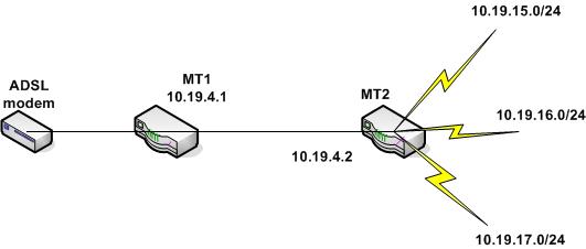

In following scenario, I have bandwidth management and PCQ type set up on MT1. ADSL modem, MT1 and MT2 are connected with ethernet cable, and MT2 with clients through wireless. My question is, are my clients 10.19.15.0/24, 10.19.16.0/24 and 10.19.17.0/24 treated like subqueues like in documentation, or the only subqueue is MT1 ↔ MT2 (10.19.4.0/24)?

Yes, my clients are using equal bandwidth capacity defined by 0 in PCQ rate. I think there is enough information in my post for answering my question. Someone?
i don’t understand your question very well (and my english is not good) but, i would like to know if your MT2 is doing some natting against MT1??
if MT2 is natting, for MT1 there is only one client, MT2 is it’s client, and PCQ is useless.
if MT2 is not natting, MT1 knows that the traffic come from the real clients (wireless clients) and the traffic is PCQed.

MT1 and MT2 have 24 bit subnet masks, and there isn’t any nat used on MT2 against MT1.

Independent if nat-ing or not, your queues should stay on mt2.
If a client has a bandwidth limit, put it as closer to him as you can. This will reduce the traffic you don’t allow in the rest of your network. Be it wired or wireless.
And, second, you are probably only doing nat on the adsl modem, or your first mt, if this is the one dialing, and not the adsl modem. right ?
I’m doing NAT only on MT1, and I can not put Queues on MT2 because I have 1 server connected to MT1 (in the future there will be more), as he is the central router, and I want that MT2 is for wireless only. My adsl modem is in bridge mode, and MT1 does pppoe connection. So, the truth is that every client has equal bandwidth in queues?
i think yes… they have equal bandwidth…

I have configured my queues and they work fine, but I’m not sure, regarding the documentation manual 2.9 on page 427 where picture is describing PCQ theory. Are PCQ subqueues in my network scenario my clients or there is only one subqueue, that is connection 10.19.4.0/24 (between MT1 and MT2)?
post here a /queue export, along with a /ip address export. You should get a straight answer then.
How many clients do you have connected wireless ?
You could make mt2 bridge between ethernet and wireless, and have a single broadcast domain. And then every single thing should be allright. This as long as you don’t have too many clients on that bridge.
I would not use that scenario with queues put on mt1. It’s just… consuming your mt1 to mt2 band.
As for the server, put a simple queue with whatever limit you want. Can’t see why would that be of any trouble. Specify dst-address and that’s it.
