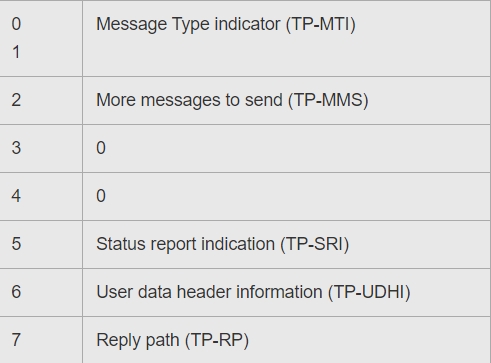

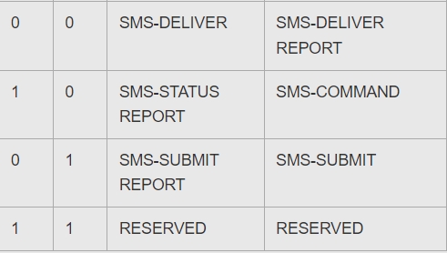

I have tried reading this post several times. But there is too much information for those who know what bytes are and how they are recalculated. But there is no clear explanation for the common man. I tried looking at your sample code you showed in another thread. I see that you use an offset to determine the PDU type, but I do not understand what is the start of the offset and why such an offset. You could explain in simple terms how to determine the type of PDU. At the moment, the only thing I seem to understand is that “04” is SMS-DELIVER. Maybe there is some set of ready-made values?
In addition to the article you mentioned, I have two more schemes, but I do not understand what they mean and how to work with them.

https://www.etsi.org/deliver/etsi_gts/03/0340/05.03.00_60/gsmts_0340v050300p.pdf
For example, I know for sure that this snippet ‘4404810102’ contains the SMS type, the length of the sender’s number, the number type, and the actual number. I know for sure that the sender’s number is ‘1020’ and the number type is ‘81’. But how is its length encrypted? It seems like it has 4 characters, so it should be ‘04’. However, according to the logic used for the SCA number, it should include 14 characters, including the number type indicator. But here, it seems that only the length of the number is specified without considering the number type characters.
Or, for example, I suspect that in this snippet ‘400DD04669B1487C3601’, the sender’s number is encrypted in alphanumeric form. The ‘40’ could represent the SMS type, and ‘0D’ the length of the SMS. But how many characters does it correspond to?
44 04 81 0102
0x44 is the SMS type
length “0x04” = 4
because 0x04 are 4 also on decimal and 4 mean four characters
0x81 is the type already explained here http://forum.mikrotik.com/t/pdu-fields-for-incoming-sms/167111/1 and is “unknown - national numbering plan”
because 1020 is one internal number of the operator.
and if you count one for each digit 1, 0, 2 and 0 are four digit, and is the same amount of digit of that 0x04 indicate…
about 40 0D D0 4669B1487C3601
0x40 type
0x0D on decimal is… 13 because for store seven 7-bit GSM-7 characters are needed 13 nibble (half byte), [for store 7 bit, each 8 bytes, one less byte is required]
and because the nibble can’t be one odd number, the last nibble is unused, but is still required 13+1 nibble = 7 bytes and 46/69/B1/48/7C/36/01 is 7 bytes long…
0xD0 is the coding: binary 1101 - 0000 = PDU encoded name with GSM-7 alphabet
4669B1487C3601 = 0x64961B84C76310 = binary 0110010010010110000110111000010011000111011000110001**0000** (notice the unused last nibble / 4 bits)
and the 7-bit 0x64 0x96 0x1B 0x84 0xC7 0x63 0x10 converted to 8-bit GSM-7 is 0x46 0x52 0x45 0x45 0x44 0x4F 0x4D,
and 8-bit GSM-7 0x46 0x52 0x45 0x45 0x44 0x4F 0x4D converted to readable CP 1252 is…
FREEDOM
