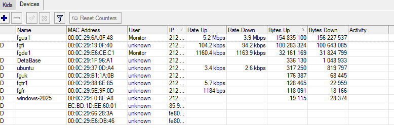

Do you see any data collected in Winbox under Kid Control - Devices? My script just takes the data generated by Kid Control.
Looking at the file you provided, I think there is something wrong with how you run the script. It should look like this (dummy data):
00:00:00:DB:00:00,XBOXONE,10.1.2.63,4967533,3788218,8755751,
yes i have dynamic and static device in kid-control
Have I made a mistake?

As a troubleshooting step, open a Terminal window in Winbox and paste this code:
It’s just an excerpt from the script without saving anything to disk.
/ip/kid-control/device
:foreach device in=[find] do={
:local mac [get $device mac-address]
# Remove colons from MAC.
:local mac2 ([:pick $mac 0 2] . [:pick $mac 3 5] . [:pick $mac 6 8] . [:pick $mac 9 11] . [:pick $mac 12 14] . [:pick $mac 15 18])
:local name [get $device name]
# Empty names or IPs will cause issues when reading into array, so replace them.
:if ([:len $name] = 0) do={ :set $name "unknown" }
:local ip [:tostr [get $device ip-address]]
:if ([:len $ip] = 0) do={ :set $ip "no-ip" }
:local down [get $device bytes-down]
:local up [get $device bytes-up]
:local total ($down + $up)
# Save data as array: 0 1 2 3 4 5
:put "$mac,$name,$ip,$down,$up,$total,"
# End of for loop.
It should produce a list of devices in the format I posted earlier.

thanks but no need to black out the mac address they are virtual made by vmware and any time i cant delete the mac address
output:
00:0C:29:E6:CE:C1,fgde1,212.xx.xx.193,13567097295,13314776453,26881873748,
00:0C:29:6A:0F:48,fgus1,212.xx.xx.194,6787106593,6758910538,13546017131,
00:0C:29:37:0D:A4,ubuntu,fe80::20c:29ff:fe37:da4;212.xx.xx.206,26387020,11721983,38109003,
00:0C:29:F0:8E:A8,windows-2025,fe80::e720:e828:8548:a53;212.xx.xx.207,146270,176998,323268,
00:0C:29:1F:96:A1,DetaBase,212.xx.xx.192,98202582,50713849,148916431,
00:0C:29:88:6E:85,fgtr1,212.xx.xx.195,693958,2672979,3366937,
00:0C:29:19:0F:40,fgfi,212.xx.xx.196,16335611419,16145100134,32480711553,
00:0C:29:5E:9F:0D,fgfr,212.xx.xx.197,488893,2168415,2657308,
00:0C:29:B1:1A:0B,fguk,212.xx.xx.198,1139875,2759023,3898898,
EC:BD:1D:EE:60:01,unknown,85.x.xx.129,0,0,0,
00:0C:29:E6:DB:46,unknown,fe80::20c:29ff:fee6:db46,0,0,0,
00:0C:29:92:F0:93,unknown,fe80::20c:29ff:fe92:f093,0,0,0,
00:0C:29:66:28:3A,unknown,fe80::20c:29ff:fe66:283a,0,0,0,
00:0C:29:A0:83:CB,unknown,fe80::20c:29ff:fea0:83cb,0,0,0,
00:0C:29:01:93:F0,unknown,fe80::20c:29ff:fe01:93f0,0,0,0,
00:0C:29:F9:ED:AE,unknown,fe80::20c:29ff:fef9:edae,0,0,0,
00:0C:29:1D:3B:01,unknown,fe80::20c:29ff:fe1d:3b01,0,0,0,
00:0C:29:30:91:D8,unknown,fe80::20c:29ff:fe30:91d8,0,0,0,
00:0C:29:AE:F9:F5,unknown,fe80::20c:29ff:feae:f9f5,0,0,0,
00:0C:29:BD:1C:35,unknown,fe80::20c:29ff:febd:1c35,0,0,0,
00:0C:29:92:DE:29,unknown,fe80::20c:29ff:fe92:de29,0,0,0,
00:50:56:BC:AE:57,unknown,fe80::250:56ff:febc:ae57,0,0,0,
00:0C:29:D2:D2:3C,unknown,fe80::20c:29ff:fed2:d23c,0,0,0,
00:50:56:BC:57:97,unknown,fe80::250:56ff:febc:5797,0,0,0,
00:50:56:84:4A:2B,unknown,fe80::250:56ff:fe84:4a2b,0,0,0,
00:50:56:BC:A6:03,unknown,fe80::250:56ff:febc:a603,0,0,0,
00:50:56:BC:0A:CF,unknown,fe80::250:56ff:febc:acf,0,0,0,
00:0C:29:30:93:EA,unknown,fe80::20c:29ff:fe30:93ea,0,0,0,
00:0C:29:DA:67:16,unknown,fe80::20c:29ff:feda:6716,0,0,0,
I also deleted all devices that had IPv6 and ran the script, but the html file was still the same as before.
output after remove ipv6 devices :
00:0C:29:E6:CE:C1,fgde1,212.xx.xx.193,840899749,830698808,1671598557,
00:0C:29:6A:0F:48,fgus1,212.xx.xx.194,7922273387,7887784538,15810057925,
00:0C:29:1F:96:A1,DetaBase,212.xx.xx.192,114360091,61259459,175619550,
00:0C:29:88:6E:85,fgtr1,212.xx.xx.195,780762,3004863,3785625,
00:0C:29:19:0F:40,fgfi,212.xx.xx.196,17739021198,17542112225,35281133423,
00:0C:29:5E:9F:0D,fgfr,212.xx.xx.197,544288,2437490,2981778,
00:0C:29:B1:1A:0B,fguk,212.xx.xx.198,1280800,3105035,4385835,

<div style='margin-left: 20%'>Report created: 2025-04-10 23:08:15</br>
Download total: 3GB</br>
Upload total: 0GB</br>
Total: 4GB</div>
<body><div id='chart_div'></div></body></html>

The files you attached all have 5-10 bytes of data. The report can show a minimum of 1 gigabyte. You simply don’t have yet enough data to be shown on the report. Just wait for a few hours, depending on how much there is activity and how often you have the script scheduled.
