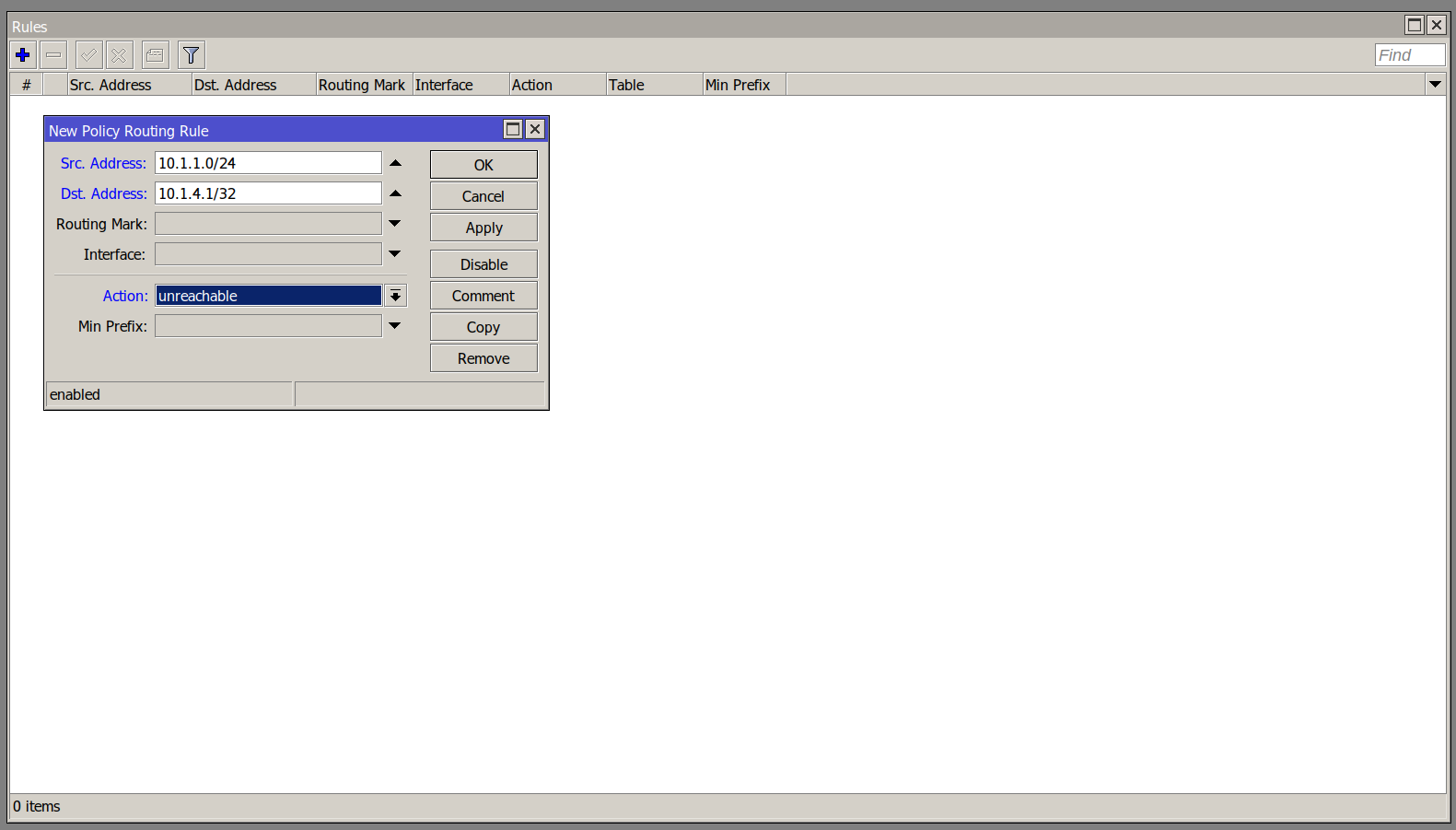

You could also add a routing-rule (aka “policy routing”)
Routing > Rules
Sure this probably kills performance too, but its a valid approach.
