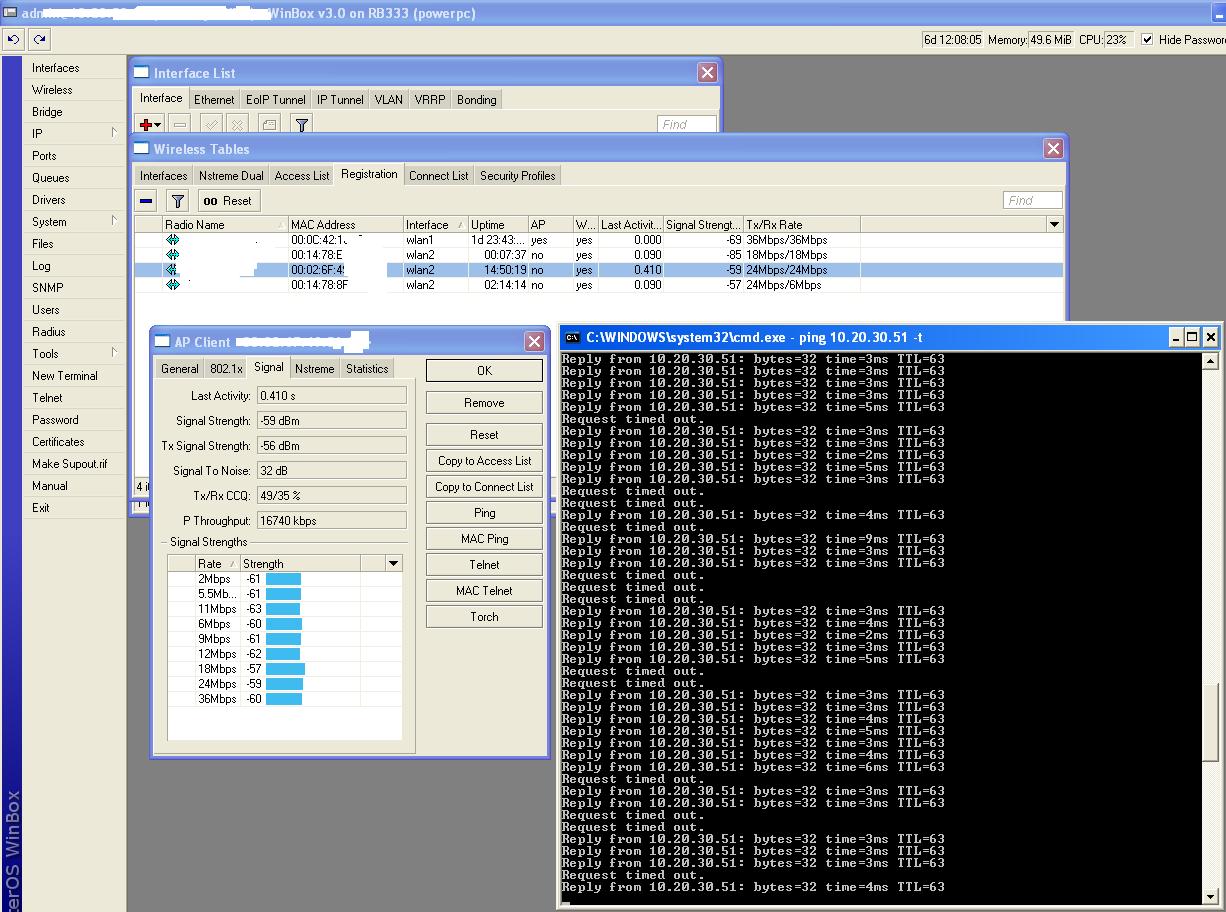

Since I’ve upgraded to 3.0 my clients get a lot of ping time out…
AP is RB 333 and clients are 2XRB411,1XRB112
AP and RB411clients have 3.0 installed
RB112 has MT:2.9.45 installd <— with no ping time out
at first i thought that iterference cause this, but I tryed evry allmoust every channel on 2.4 GHz
what is wrong with 3.0 version?
second station at -85 is your problem. Remove it and everything should be fine
it worked fine befor upgradeing it to 3.0… and if I switch channal signal increases to -77 dBm with the same problem (ping time out)
Try shutting the -85/-77 customer off and see what happens.
Also, try decreasing your power.
