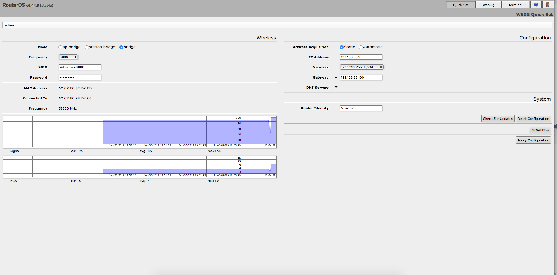

192.168.88.2

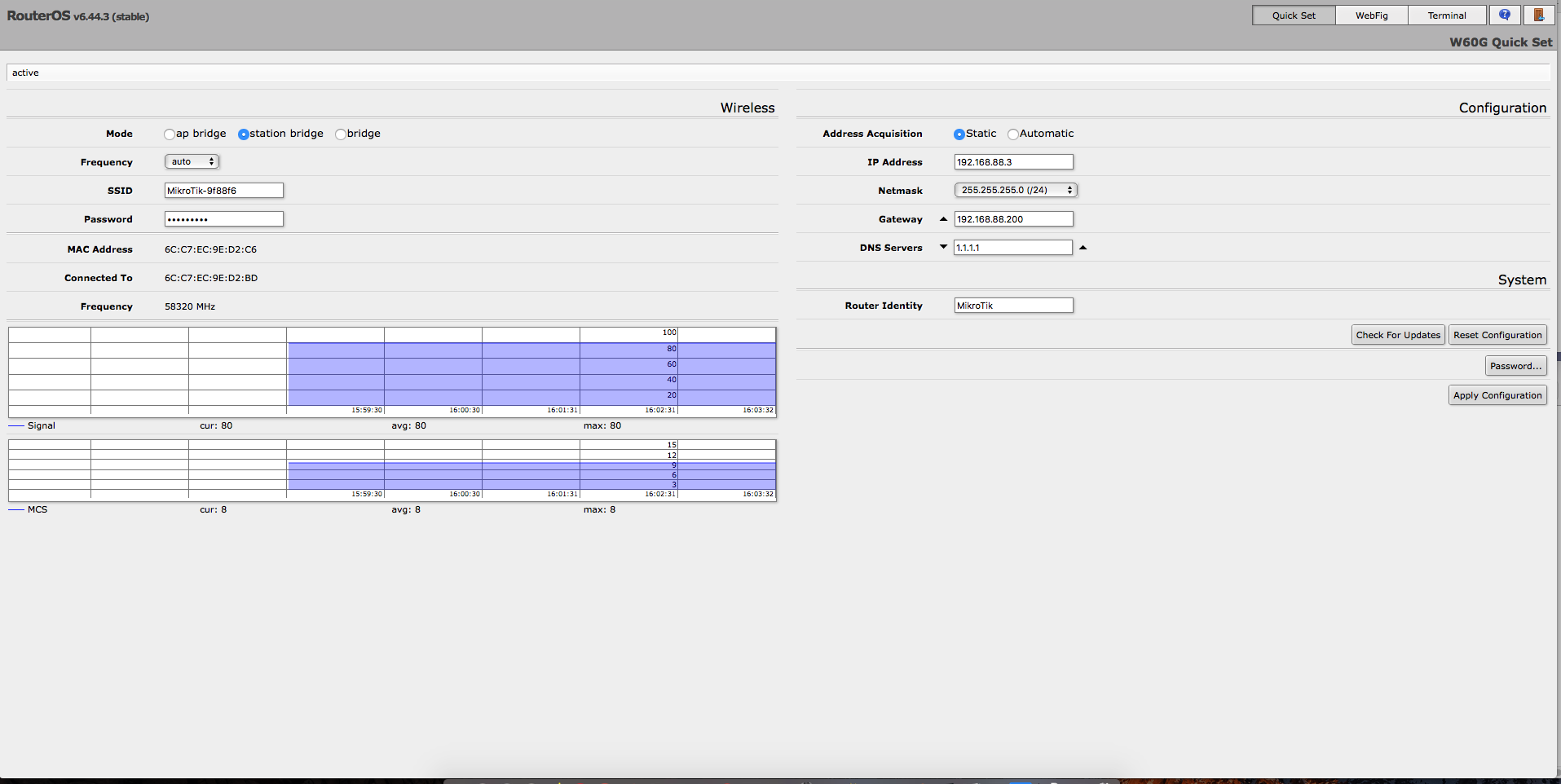

192.168.88.3

192.168.88.2
frequency: 58320
remote-address: 6C:C7:EC:9E:D2:C6
tx-mode: dmg
tx-mcs: 8
tx-phy-rate: 2.3Gbps
signal: 95
rssi: -50
tx-sector: 59
tx-sector-info: left 0.2 degrees, up 1.4 degrees
distance: 71.79m
tx-packet-error-rate: 0%
– [Q quit|D dump|C-z pause]
192.168.88.3
frequency: 58320
remote-address: 6C:C7:EC:9E:D2:BD
tx-mode: dmg
tx-mcs: 8
signal: 80
rssi: -48
tx-sector: 59
distance: 71.72m
Signal and RSSI and MCS seem to be correct.

Mac-Mini-i7:Downloads TPF$ ./iperf3 -c 192.168.4.121 -P4
Connecting to host 192.168.4.121, port 5201
[ 4] local 192.168.6.41 port 61353 connected to 192.168.4.121 port 5201
[ 6] local 192.168.6.41 port 61354 connected to 192.168.4.121 port 5201
[ 8] local 192.168.6.41 port 61355 connected to 192.168.4.121 port 5201
[ 10] local 192.168.6.41 port 61356 connected to 192.168.4.121 port 5201
[ ID] Interval Transfer Bandwidth
[ 4] 0.00-1.00 sec 4.46 MBytes 37.4 Mbits/sec
[ 6] 0.00-1.00 sec 873 KBytes 7.15 Mbits/sec
[ 8] 0.00-1.00 sec 1.67 MBytes 14.0 Mbits/sec
[ 10] 0.00-1.00 sec 3.56 MBytes 29.8 Mbits/sec
[SUM] 0.00-1.00 sec 10.5 MBytes 88.4 Mbits/sec
[ 4] 1.00-2.00 sec 546 KBytes 4.47 Mbits/sec
[ 6] 1.00-2.00 sec 4.36 MBytes 36.6 Mbits/sec
[ 8] 1.00-2.00 sec 1.01 MBytes 8.48 Mbits/sec
[ 10] 1.00-2.00 sec 3.92 MBytes 32.9 Mbits/sec
[SUM] 1.00-2.00 sec 9.83 MBytes 82.4 Mbits/sec
[ 4] 2.00-3.00 sec 273 KBytes 2.23 Mbits/sec
[ 6] 2.00-3.00 sec 4.41 MBytes 36.9 Mbits/sec
[ 8] 2.00-3.00 sec 2.96 MBytes 24.8 Mbits/sec
[ 10] 2.00-3.00 sec 285 KBytes 2.33 Mbits/sec
[SUM] 2.00-3.00 sec 7.92 MBytes 66.2 Mbits/sec
[ 4] 3.00-4.00 sec 1.57 MBytes 13.2 Mbits/sec
[ 6] 3.00-4.00 sec 1.91 MBytes 16.0 Mbits/sec
[ 8] 3.00-4.00 sec 2.81 MBytes 23.6 Mbits/sec
[ 10] 3.00-4.00 sec 2.05 MBytes 17.2 Mbits/sec
[SUM] 3.00-4.00 sec 8.35 MBytes 70.0 Mbits/sec
[ 4] 4.00-5.00 sec 2.99 MBytes 25.2 Mbits/sec
[ 6] 4.00-5.00 sec 2.99 MBytes 25.2 Mbits/sec
[ 8] 4.00-5.00 sec 1.92 MBytes 16.2 Mbits/sec
[ 10] 4.00-5.00 sec 3.03 MBytes 25.5 Mbits/sec
[SUM] 4.00-5.00 sec 10.9 MBytes 92.0 Mbits/sec
[ 4] 5.00-6.00 sec 3.34 MBytes 28.0 Mbits/sec
[ 6] 5.00-6.00 sec 2.79 MBytes 23.4 Mbits/sec
[ 8] 5.00-6.00 sec 2.40 MBytes 20.2 Mbits/sec
[ 10] 5.00-6.00 sec 786 KBytes 6.44 Mbits/sec
[SUM] 5.00-6.00 sec 9.30 MBytes 78.1 Mbits/sec
[ 4] 6.00-7.00 sec 2.06 MBytes 17.3 Mbits/sec
[ 6] 6.00-7.00 sec 3.92 MBytes 32.9 Mbits/sec
[ 8] 6.00-7.00 sec 2.00 MBytes 16.8 Mbits/sec
[ 10] 6.00-7.00 sec 867 KBytes 7.10 Mbits/sec
[SUM] 6.00-7.00 sec 8.82 MBytes 74.0 Mbits/sec
[ 4] 7.00-8.00 sec 5.14 MBytes 43.1 Mbits/sec
[ 6] 7.00-8.00 sec 2.84 MBytes 23.8 Mbits/sec
[ 8] 7.00-8.00 sec 121 KBytes 991 Kbits/sec
[ 10] 7.00-8.00 sec 1.42 MBytes 11.9 Mbits/sec
[SUM] 7.00-8.00 sec 9.52 MBytes 79.8 Mbits/sec
[ 4] 8.00-9.00 sec 5.26 MBytes 43.9 Mbits/sec
[ 6] 8.00-9.00 sec 1.14 MBytes 9.51 Mbits/sec
[ 8] 8.00-9.00 sec 2.61 MBytes 21.8 Mbits/sec
[ 10] 8.00-9.00 sec 740 KBytes 6.04 Mbits/sec
[SUM] 8.00-9.00 sec 9.73 MBytes 81.3 Mbits/sec
[ 4] 9.00-10.00 sec 4.74 MBytes 39.9 Mbits/sec
[ 6] 9.00-10.00 sec 3.10 MBytes 26.1 Mbits/sec
[ 8] 9.00-10.00 sec 368 KBytes 3.02 Mbits/sec
[ 10] 9.00-10.00 sec 676 KBytes 5.56 Mbits/sec
[SUM] 9.00-10.00 sec 8.86 MBytes 74.6 Mbits/sec
[ 4] 0.00-10.00 sec 30.4 MBytes 25.5 Mbits/sec sender
[ 4] 0.00-10.00 sec 30.2 MBytes 25.4 Mbits/sec receiver
[ 6] 0.00-10.00 sec 28.3 MBytes 23.8 Mbits/sec sender
[ 6] 0.00-10.00 sec 28.2 MBytes 23.6 Mbits/sec receiver
[ 8] 0.00-10.00 sec 17.9 MBytes 15.0 Mbits/sec sender
[ 8] 0.00-10.00 sec 17.7 MBytes 14.9 Mbits/sec receiver
[ 10] 0.00-10.00 sec 17.2 MBytes 14.5 Mbits/sec sender
[ 10] 0.00-10.00 sec 17.1 MBytes 14.4 Mbits/sec receiver
[SUM] 0.00-10.00 sec 93.8 MBytes 78.7 Mbits/sec sender
[SUM] 0.00-10.00 sec 93.3 MBytes 78.3 Mbits/sec receiver
iperf Done.

What about UDP?
Is that with the small Wireless Wires or the dishes?
This test is worse than ever. The fact that it never gets above 100 Mbps is concerning; are the cables on both ends OK?
This is LHG60 Wireless Dish.
The wiring gives me the impression that it is fine.
Something must be failing in the configuration because this is not normal.
UDP fails?
