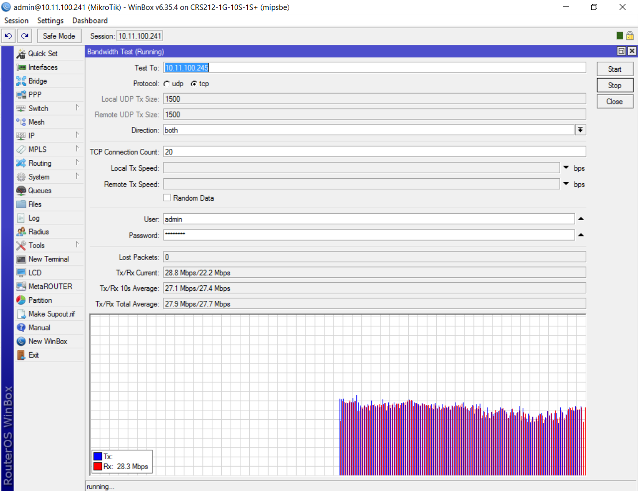

I have recently purchased a CRS212-1G-10S-1S+ and a CCR1072-1G-8S+. I linked the two devices together using a 3m DAP cable and two of the SFP+ ports.

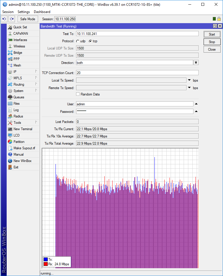

As per the image below, when doing a bandwidth speed test between the two directly connected devices results in what I would deem as sow performance.
Could someone please advise if there is any Fibre related settings that I an overlooking to increase the throughput,?
What happens when you change the protocol to UDP?
You should bandwidth test through the device, not on it. Generating the bandwidth is limited to a single core, so it will not reach maximum performance.

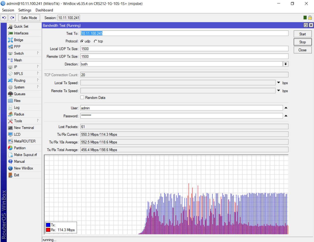

Using 2x CRS212-1G-10S-1S+ connected via the SFP+ ports (10gb) to ports 1 and 2 on the CCR1072-1G-8S+ and performing a bandwidth test through the device gives roughly the same performance as per the image below.
Changing the Bandwidth parameters to use UDP instead gives the following results.
Considering that all these devices are linked using 10gb equipment, what type of performance should I be expecting?
You are probably maxing out the processor on the devices you are testing from rather than the devices being tested. I’m fairly certain that you shouldn’t be running the bandwidth test on the CRS devices. You are very likely maxing the CPU on the ones running the test. You need something with more processing power. I haven’t had a chance to play with the CCR1072s, but one of those on each end, or some decent PCs or servers running the btest software on the Mikrotik Software page I would think should give you better results.
