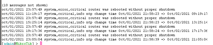

I’m running 7.1rc4 on an RB4011 since a while.
At some point I noticed that it reboots periodically (really always somewhen after 3,5 - 4 hours runtime).
Unfortunately I do not have much more information than that. I obviously could provide a supout but the forum says to report issues here and not to support@.

What I find intriguing here is that after each crash it goes back to more or less the same “base” time.
Oct 1 2021, 21h58 and some seconds.
I would expect the internal clock goes up as the device operates normally ?
So that looks fine at least, right?
The config is fine - its obviously being set by ntp - but the curious point the other poster was making is that the boot time is always the same to ~2 days ago, all your ‘reboot without proper shutdown messages’ default back to oct 01 23:57:49 - is this when you upgraded/installed 7.1rc4? Sounds like some kind of memory leak and nothing is really saving on the underlying system so resets back to that point like it was refresh.

After an reboot I have a warning in Terminal that the time has been adjusted by the NTP-client.
Normal on a reboot the that is 1970-01-01 00:00 and that was on v6.
V7 could just like a RaspberryPI save the last know date and time when doing a reboot and use that as start from time. However if you boot your device weeks later that save data is well out of date.
It could be the same here that the last known time is saved and reused on boot in the time before a NTP sync or the user manually setting date and time.
In your case it seems that the saved time is never (re)set because the router hard crashed.
That was exactly the point I was making with my earlier remark.
Going on a stretch … the crash might be related to this internal time not advancing as it should ? Some code not reading the ‘real’ time, or something related.
Speculation, I know.
