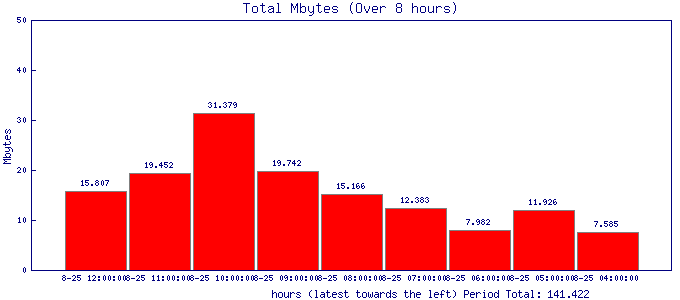

The second script produces graphs based upon the data, I’ve attached an example output image.

graph.pl:

my $graph = GD::Graph::bars->new(85*$num_values, 300);
$graph->set(
    x_label     => "$period_type (latest towards the left) Period Total: $period_total",
    y_label     => 'Mbytes',
    title       => "Total Mbytes (Over $num_values $period_type)",
    transparent	=> '0',
    show_values => '1',
    bar_spacing => '2',
) or warn $graph->error;
my $image = $graph->plot($graphvalues) or die $graph->error;
open(IMG, ">$graph_image_file") or die $!;
binmode IMG;
print IMG $image->png;
