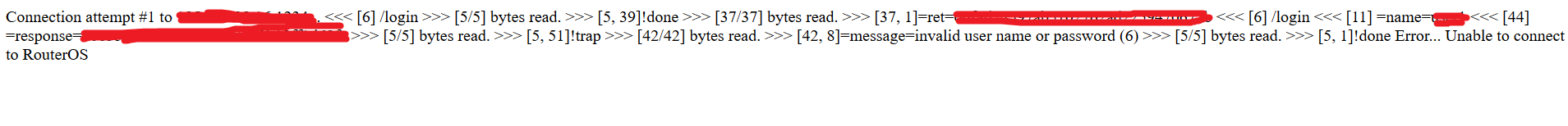

When i run the code, it says 'invalid user name or password - Unable to connect to RouterOS ’ . But the same login credentials works fine with WINBOX

If you can see connection attempt in router’s log, then it clearly passed through firewall, otherwise it wouldn’t be there at all.
Yes you are right! I don’t know whats the exact issue.. Can you please help me to check it?
The class I linked to works fine for me, so I don’t know what can be wrong. Add some more debug output in connect(), just simple “echo” is fine, to see what exactly fails. Dumping $RESPONSE is good start.
Ok sure.
Result of : $RESPONSE = $this->read(false) :
Array
[0] => !trap
[1] => =message=std failure: not allowed (9)
[2] => !done
I don’t know what that is, but maybe some problem with permissions for used username?
Ohh ok.. I will check and get back to you.
