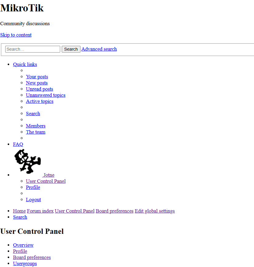

It seems that most of the graphics is gone on this board when I do use Prosilver. Looks ok in Canvas.
But for me Canvas is just bad to use, so Prosilver needs to be fixed.

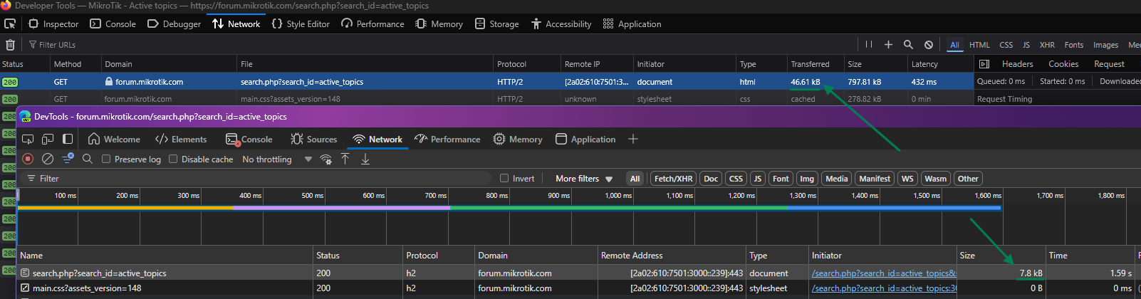

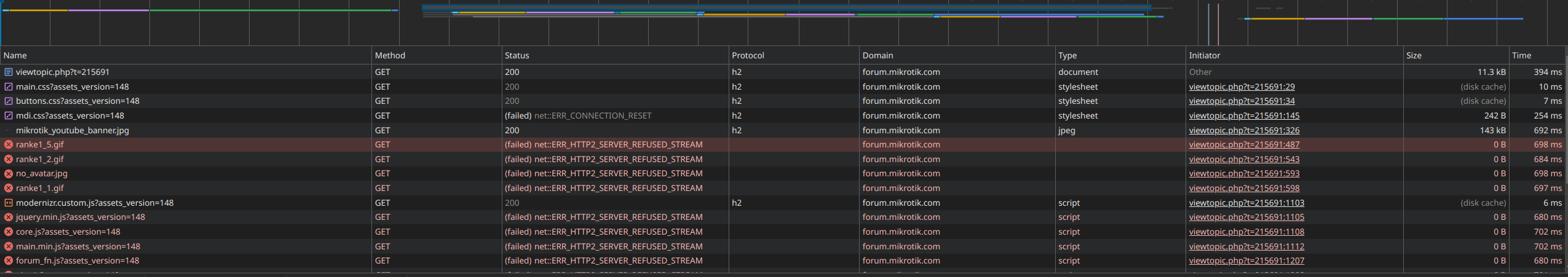

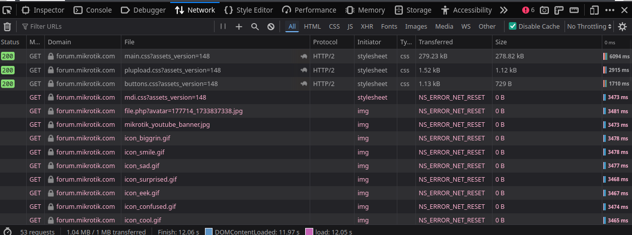

Yes, others will probably encounter the issue too if they cleared their browser cache. There is a problem with the forum server since a couple of days. Large transfers are stopped in the middle (usually with connection reset or partial content error). As a result, if the resources are not yet cached, then you’ll see placeholders and missing stylesheets/scripts everywhere, until you’ve navigated around or reloaded the page a couple of times (the missing resources are gradually loaded successfully).

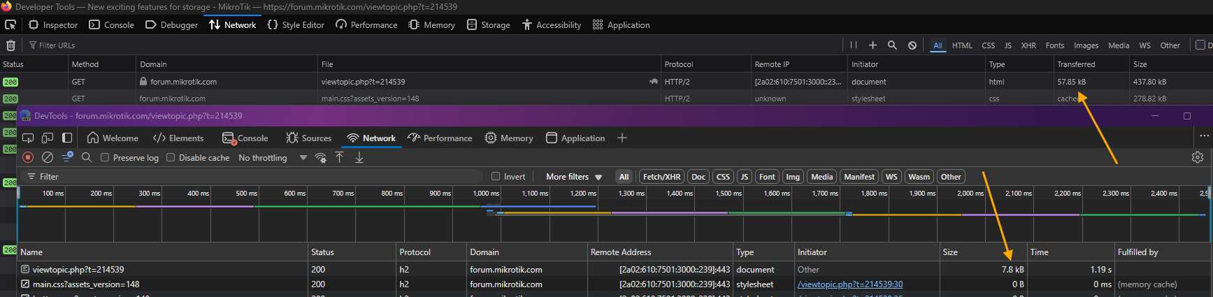

But because of this problem with transfer being abruptly stopped, the forum is currently unusable for me on Chromium based browsers. Because large threads are cut in the middle. I’ve tested with mobile and desktop browser on 3 different ISPs, both with IPv4 and IPv6 and the problem is present everywhere. If the thread is small enough then the content can be loaded til the end, but with missing avatars.
Currently only Firefox works for me with the forum, because it looks like Firefox does try to resume the loading of the thread pages when the connection is reset. But in the status bar you can clearly see that FF had to reestablish the connection multiple times, including new TLS negotiations. And of course, the referenced resources fail to load most of the time if not yet cached, and requires multiple retries.
Below are screenshots showing Edge and Firefox trying to load the “Active Topics” page and this thread http://forum.mikrotik.com/t/new-exciting-features-for-storage/181774/1 On edge only 7.8KB could be transferred for the HTML content.

This has nothing to do with phpBB IMHO. Even static assets like https://forum.mikrotik.com/styles/canvas/theme/images/mikrotik_youtube_banner.jpg or https://forum.mikrotik.com/images/smilies/icon_confused.gif sometimes don’t load here at my side. Opening https://forum.mikrotik.com/styles/canvas/theme/images/mikrotik_youtube_banner.jpg in a dedicated tab loads the banner image normally.
Firefox says “NS_ERROR_NET_RESET”, Chromium “ERR_HTTP2_SERVER_REFUSED_STREAM”.

As a Prosilver user I tried going to the profile page and selecting the other theme (forgot the name) and it shows a usable layout but also without icons.
And now I cannot find where to click to go back to the profile settings and select Prosilver again :frowning: :frowning:
