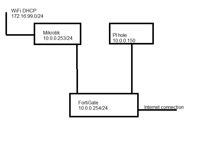

I have change my setting to this:
when a clinet connect to the WiFi he get address from mikrotik 172.16.99.0/24 (pool 1-50) , The WiFi is 172.16.99.254
and have internet connection without any problem.
I have connected the PI-hole and setup DNS server in Mikrotik to 10.0.0.150
everything is working , no ads on website.
but on PI-Hole logs I can only see 10.0.0.253 as the only one the request DNS service from me
is there anything I can do in order to see the WiFi DHCP I’m giving? 172.16.99.0/24?

That is correct because it seems the WiFi clients are NATTED and their source address become the address of the router.
If you want your client IP then the WiFI should be in the same sub-net 10.10.10.0/24 to skip the NAT.
And put in the DHCP server settings the DNS address of the pi-hole.
I don’t want the WiFi to be as the same as the reset of the network
I have other servers \ computer \ devices on the netwrok I don’t them to have access to .

can I do the following :
change the Ether1 IP to 10.0.0.253/29
change WiFi IP to 10.0.0.50/28 (and setup the pool to 50-60)
route 0.0.0.0/0 to fortigate 10.0.0.254 (as now)
disable the NAT
make firewall rule that block all WiFi address to 10.0.0.200-10.0.0.220 (this is where I don’t want to WiFi to have access to )
can this do the jpb?
what do you think?
No, that wouldn’t do, because neither 10.0.0.150 (pihole) nor 10.0.0.254 (router) are members of subnet 10.0.0.50/28 (which covers IP addresses between 10.0.0.48 and 10.0.0.63), hence WiFi clients wouldn’t be able to reach pihole or internet directly. Which means you’d still have to run NAT on mikrotik, defying the whole exercise.
What you could do is to place everything (including WiFi clients) in 10.0.0.0/24 subnet, bridge ether1 and wlan1 on mikrotik, use whatever DHCP server you have in your LAN (fortigate?) with appropriate pool (add static leases for known LAN clients) … and enable use-ip-firewall=yes property of bridge. Just in case explicitly set hw=no on wlan bridge port (traffic to/from wlan can’t be HW offloaded anyway, there’s no switch chip involved). Then construct appropriate firewall rules to block traffic originating from WiFi IP address list to anything but fortigate. Don’t forget to place appropriate rules also in chain=input to defend mikrotik from those evil WiFi clients.
