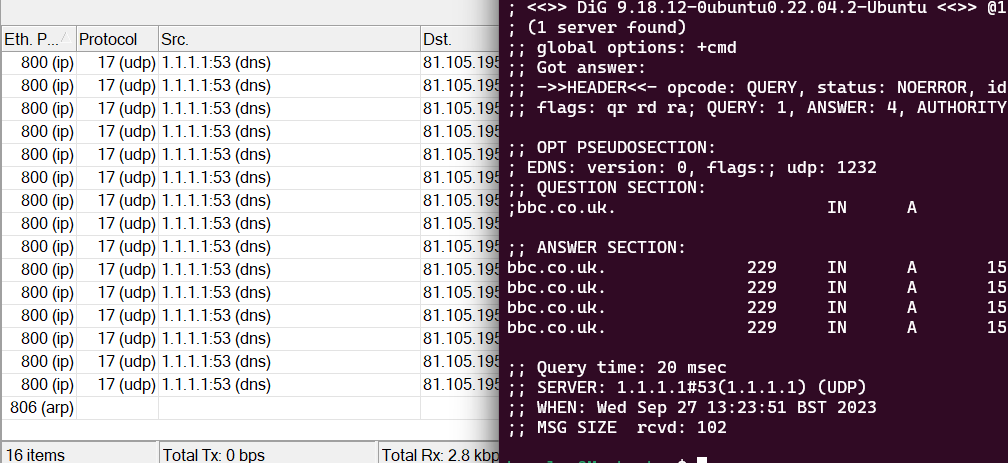

@ToTheFull
do u have it on same lan range?
Yes but the device was set static from a previous install, so it maybe be something to do with that not sure.
IE my dhcp server range is 192.168.88.100/253
dns 192.168.88.10 it doesn’t appear in the pool etc.
