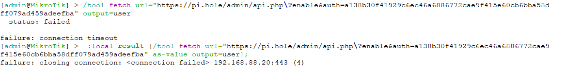

Then I use fetch as-value I get exception which terminates my whole script. But then I use normal fetch I get normal result with status=failure.
Then I try to print as-value result to log, nothing appears too.
I expected to get failure status as variable which then I could use to handle in script. Instead script dies on fetch command, also this exception is not logged by my default settings.
Example in terminal (which I expect to behave the same, except saving results to variable then using as-value):
I use self-signed certificate in PiHole webserver.

Appending script I want to use in scheduler (status=failed part doesn’t work, because script dies in first line):

You can wrap the tool fetch command in a do { } on-error={ } construct to handle it if it fails :
#initialize result as an array
local result ({})
do {
set result [/tool fetch url="http://something.at/somwhere" output=user as-value]
} on-error={
#this part triggers if previous mikrotik command errors out
#set status key to failed
set ($result->"status") "failed"
#continue handling as normal
