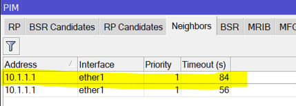

Router2 - \routing\PIM\Neighbors
We see that when the Ether1 connection was re-established, a new addition entry is made in the neighbors list. Eventually the original neighbor entry counts down to zero and is removed from the list.
At this point all is still working correctly. Multicast traffic is still flowing between senders and receivers.

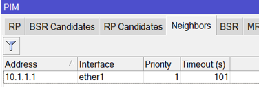

At this point, I again provide an interruption by temporarily unplugging the CAT6 connection to the Ether1 port of Router2. I then plug the connection back in after a few seconds.
Interrogating Router2, we make the following observations.
We can see here that Interface ether1 has lost its PIM neighbor
Router2 - \routing\PIM\Interface
We see that on this occasion, when the Ether1 connection was re-established, a new addition entry was NOT created in the neighbors list.
