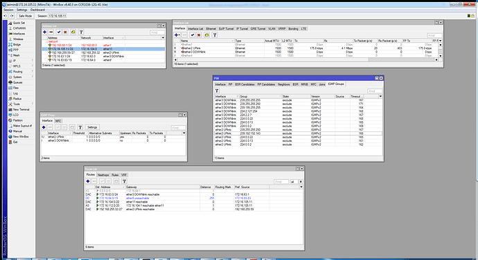

routing igmp-proxy interface p
Flags: X - disabled, I - inactive, D - dynamic, U - upstream
INTERFACE THRESHOLD
0 IU ether2 UPlink 1
1 I ether3 DOWNlink 1
why Interfaces is Inactive?

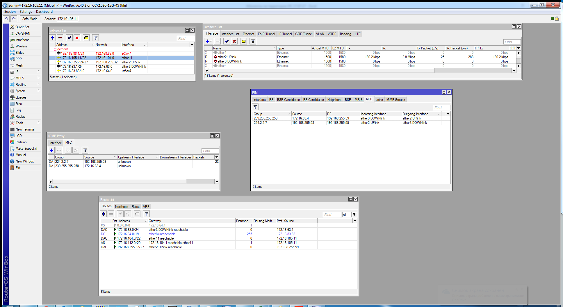

routing pim mfc p
GROUP SOURCE RP
224.0.1.1 172.16.104.2 192.168.255.59
224.2.2.7 192.168.255.58 192.168.255.59
239.192.152.143 192.168.255.58 192.168.255.59
239.255.255.250 172.16.63.4 192.168.255.59

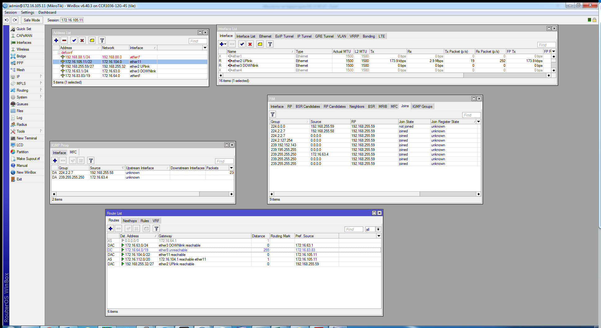

routing pim join p
Flags: RP - (,,RP), WC - (*,G), SG - (S,G), SG_rpt - (S,G,rpt)
GROUP SOURCE RP
WC 224.0.0.0 192.168.255.59 192.168.255.59
SG 224.2.2.7 0.0.0.0 192.168.255.59
SG 224.2.127.254 0.0.0.0 192.168.255.59
SG 239.192.152.143 0.0.0.0 192.168.255.59
SG 239.195.255.255 0.0.0.0 192.168.255.59
SG 239.255.255.250 0.0.0.0 192.168.255.59
SG 239.255.255.255 0.0.0.0 192.168.255.59
SG_rpt 224.0.1.1 172.16.104.2 192.168.255.59
SG_rpt 224.2.2.7 192.168.255.58 192.168.255.59
SG_rpt 239.192.152.143 192.168.255.58 192.168.255.59
SG_rpt 239.255.255.250 172.16.63.4 192.168.255.59

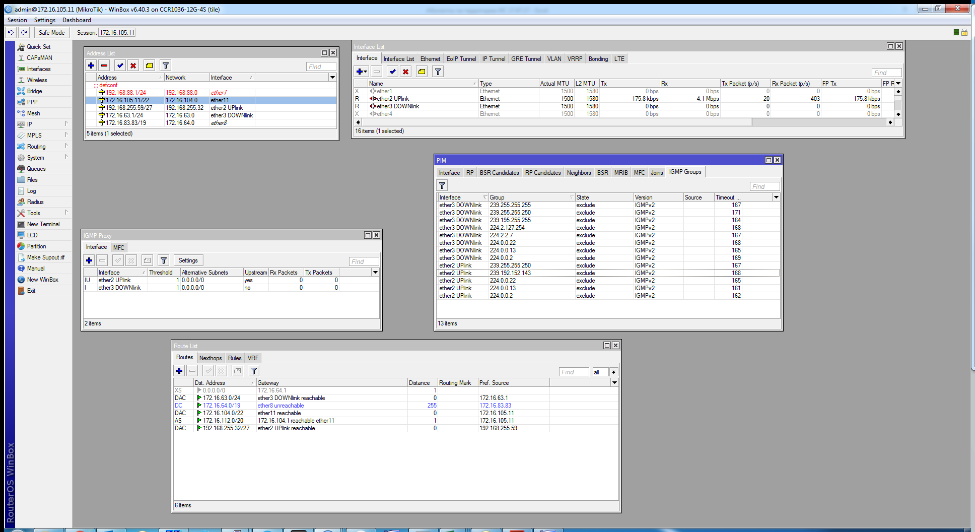

routing pim igmp-group p
Flags: v1 - IGMPv1, v2 - IGMPv2, v3 - IGMPv3, I - include, E - exclude, F - forward, D - don't forward
INTERFACE GROUP SOURCE TIMEOUT
v2E ether3 DOWNlink 224.2.2.7 0.0.0.0 3m38s
Why Interfaces in IGMP-Proxy is Inactive? Is it - issue?
In PIM/MFC i see Group 224.2.2.7 - Source 192.168.255.58 - RP 192.168.255.59 - incoming Int "ether2 Uplink" - Outgouing int "ether3 DownLink"
And in Interfaces list i see Rx on "ether2 Uplink" but dont see due TX on "ether3 DownLink"
