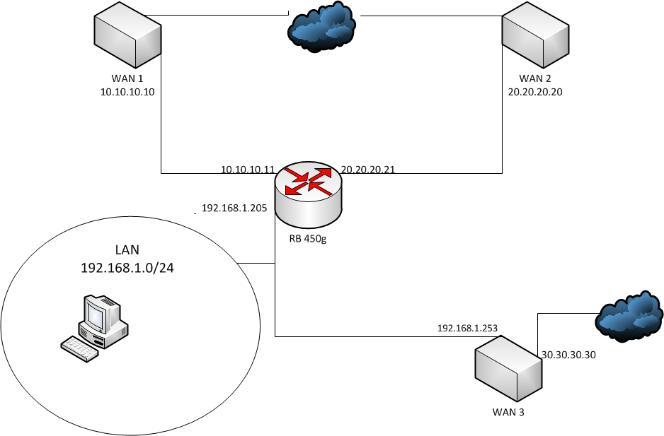

I think I got it now, but a simple drawing will remove any doubts :slight_smile:
Well, 192.168.1.0/24 is you local LAN. Your gateway that is masqueraded to the internet is 192.168.1.253
This works OK if it is your only gateway to the internet. You should either change your LAN to 192.168.2.0/24, or change the 192.168.1.253 to something else if you have access to that device. All the WAN’s should come straightforward to your 750G and then you can do whatever you wish (load balancing, etc)
Please, attach a simple drawing to be sure about your network.
Here is my network topology
For start, if you can, change the WAN3 IP address to, let’s say 192.168.10.x. You need any other subnet than those you are couurently use ofr other WANs or LAN.
Or, if you don’t have access to that device, you will need to change your LAN’s subnet. This means all computers in the local LAN will need to change IP.
This is the most clear way to setup your network
Seems to me like a default route problem. Do the hosts on 192.168.1.0/24 use .253 as their default gateway? If yes, that is your problem. They receive a packet from a source address outside their broadcast domain. While it enters the network through the RouterBOARD, the clients don’t have specific routes back, so they send the packet to .253. That router is going to also source NAT the reply, and while the packet might make it back across the Internet, it will come back with a different source IP and the host that originally initiated the connection will discard the packet.
There really isn’t a good solution to this other than making the RouterBOARD the gateway for the LAN. For the time being you can still point the RouterBOARDs default route back out through .253, but at least it could continue the connections it originated via directly connected networks.
Correct, absolutely correct. That was the main reason I suggested to put LAN and any WAN into different subnets.

@both:
everything I’m testing is from my own computer, and my default gateway is .205.
OK, i disconnected myself completley from the LAN and made my own lan 10.0.0.0/24. My address is .2, eth5 on the router is .1
So now there’s only WAN1, WAN2 and me.
Everything is still the same. Radmin packets entering, but now reaching me.
Do you want me to print some of the configuration and what?
I can’t change anything in LAN. My servers are in the same LAN and there is a lot of complicated bindings involved. They have to stay in 192.168.1.0/24. Same thing applies for the .253. It is their default gateway
Worst case scenario :slight_smile:
But if your LAN is on 192.168.1.0/24 and the gateway of the clients in that LAN is 192.168.1.253, no traffic is forwarded by your router on 192.168.1.205. The clients (your servers) are simply talking directly to their gateway (.253) and does not even know about presence of your router.
You must be able to do some changes to your configuration to get the things as you would like them to be. There is no other way, sorry :frowning:
