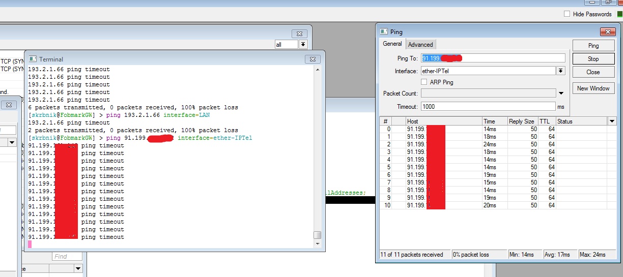

I think I have discovered a bug in ping from terminal.
If I ping and address (on the other end of IPSEC tunnel) from Ping tool (with the right interface) it works but if I use terminal (or from script) it does not work.
Can Anyone confirm this befor I send it to Mikrotik Support..
It is I problem because my IPSEC tunnel occasionaly falls and I have to flush Installed SA. I have created a script but it always says ping timeout even though the tunnel is OK…

Hello.
Just noticed some problem with ping: seems like if one uses ‘interface=some-ppp-iface’ parameter in Terminal, it’s not working:
[admin@MikroTik] > /ping 10.100.1.1 interface=ipip-datacenter
10.100.1.1 ping timeout
5 packets transmitted, 0 packets received, 100% packet loss
[admin@MikroTik] >
But at the same time, ping from WinBox works fine with the same parameters (target IP and interface selected).
