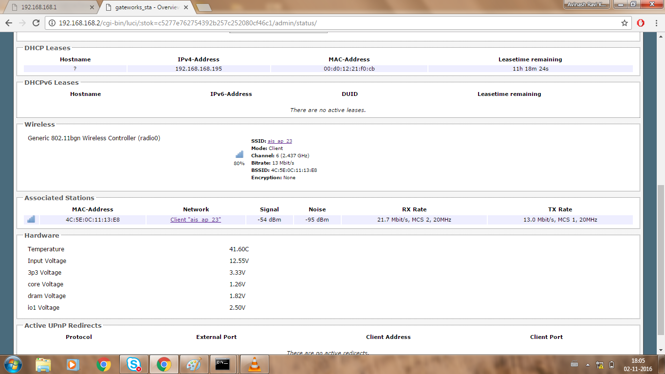

The data flow obtained at the receiver was an average rate of 13 Mbps & the ccq waqs 80%. The RSSI at the receiver was -54dBm. Since it was a remote area, we did not do a spectral scan as there are no other devices in the vicinity. I have attached the snapshot of the page of the receiver for your reference taken at the point when the streaming failed. Thanks a lot for your time.

You should use directional or at least panel antennas on both sides and the same for both chains or better dual polarised antennas. Make sure the fresnel zone is free, you could need to rise the antennas higher above the ground level. Consult configuration questions on openwrt forum or the forum related to your devices, you are definitely not running ros.
