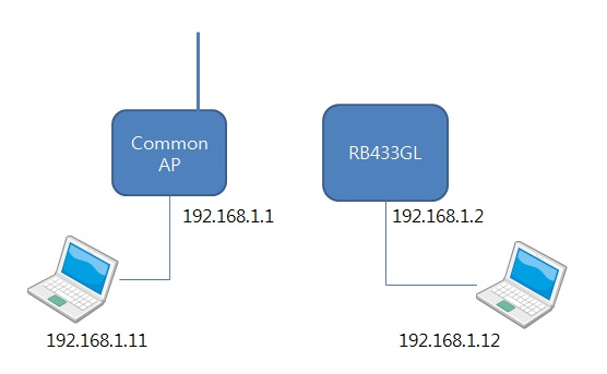

Using 433GL, I test connect to CPE(AP).
192.168.1.12 PC can receive ping reply from all(192.168.1.1/2/11)
But 192.168.1.11 PC is only receive from 192.168.1.1. cannot receive from 433GL(192.168.1.2).
433GL is set as Station mode. ARP= Proxy ARP.
There is no Firewall setting.
Let me know what did I wrong?
Why don’t u try WDS mode…
have you configured Proxy-ARP on Common AP too…
WDS mode is dependent on the AP as well.
Station Pseudobridge may do the trick here.
What are you trying to do? Bridge a network? Just get on the Internet?

can post you detail configuration?
The standard 802.11 can’t use to bridge with 802.3 ethernet, There’s better use WDS Transparent bridge in replacement of psudo-bridge
http://wiki.mikrotik.com/wiki/Transparently_Bridge_two_Networks
you can use Dynamic Mesh and AP Bridge when you want to make bridge between more than 2 devices.
