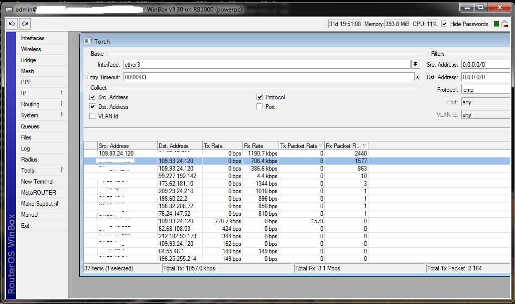

Has anyone seen anything like this before? For the life of me I can’t seem to stop them. Packet rates for some machines will get over 6000, and it basically brings my network to a crawl. Since there are no return packets, I can’t get a good feed on what is really going on here. HELP PLEASE!! These are all icmp packets by the way.

I am the provider. What I am trying to do is stop these packets from clogging up the processing power of the backhaul link that feeds this particular router. I believe these are fragmented icmp packets. I have conntracking enabled, so how can I stop these packets? Do I need to disable connection tracking?
Oh, I see. I’d probably start with finding the entry point and rate limiting icmp there (permit incoming icmp that isn’t established at a reasonable rate and drop the rest). Then find the owners of the offending IPs and contact them for resolution.
