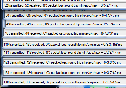

Seems like something else is going on… I started a bunch of pings from the dude and had 0 packet loss.
Here it shows 9 pings running. Have you tried to change the dude to run as high or real time priority?
