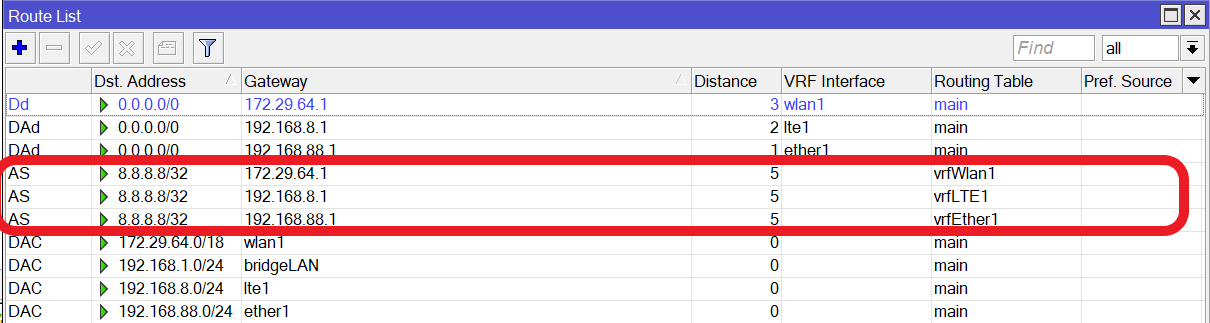

I made a script, which is pinging over three different wan-interfaces. I had earlier the problem that I could not even ping the different interfaces separately. I found the solution to add vrfs like in the following picture:
After that I added different elements in the route list as in the following picture:
I am using the “vrf”-element in the ping tool to realize my Problem with pinging the different interfaces separately.

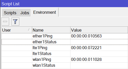

Now to my problem:

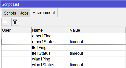

Sometimes I get timeouts as in the following picture and sometimes it gives me the right output:
The timeouts turning up for some seconds and go away again for some minutes.
Is this a normal behaviour? Do I used the right config? If not could someone tell me how to get it right? I do not want timeout if the interfaces are working correctly.

When you are pinging other people’s (Google’s) servers, you will have to live with other people’s TOS.
That is always a risk when using “ping of external server” as a method to determine if your link is up or down: it may be not your link but the other computer that is up or down (or chooses not to answer ping).
Thank you very much for your reply. I decided to ping to 1.1.1.1 and the timeouts did not appear anymore until now.
This will work until they blacklist you for excessive pings…
