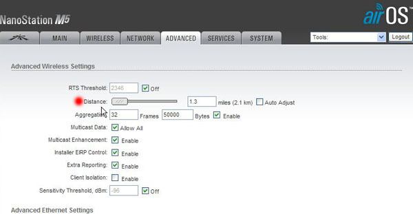

Have you enabled airmax on the rocket don’t do that

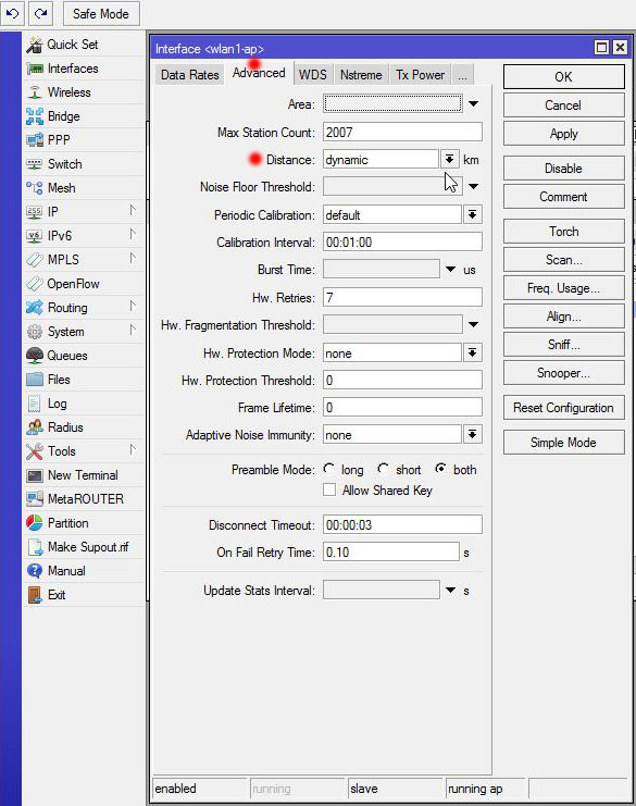

What distance have you fill in the rocket?
Full the same distance in on the client side by advanced settings
Remember that DFS interupt your link for a few seconds if a radar is detect
SXT must not configured with Nv2 for link to the rocket.
Sorry for my bad english i try to help you
should I put estimated distance of wireless link? (in client’s configuration)
Yes, the distance is verry inportant for the link see that you the same distance fill in to the client also to the ap
On accesspoint side get the distance field of your farthest link and fill also in at the client side
Thats in the rocket by advanced settings.

distance in this format? 0.1km?
best is just 1km not with .5
How match is the real distance?
You may fill in a little more away than in reality.
Better too much than too little km
In straight line about 240meters
Normal have you change the ack-timing on 500 meters
240 meters are verry close i thought that it was further.
try to set both sites to 1 km for test
After that ping and see the result of it is better.
Let me know

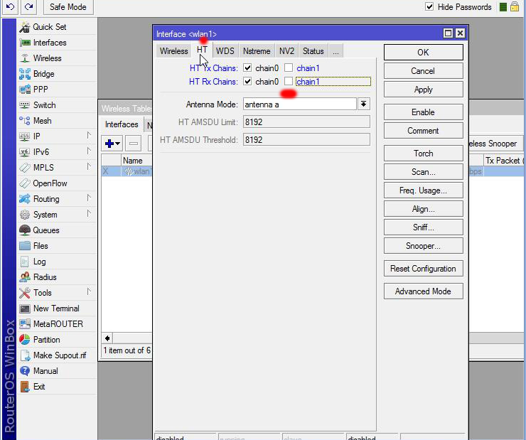

One more point.
Are on SXT In “wireless” “HT” all the chains ticked so “no” all the chains must by activated
