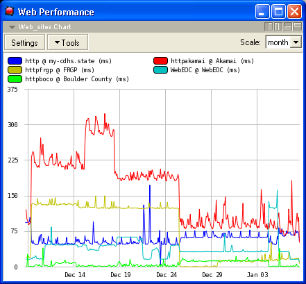

I tried to put a tcp http probe on a label and it didn’t work. Not that this works for you but I have the 5 web sites I am tracking added to a chart then I made a panel out of that chart. Note: A panel will save the legend and scale between views, a chart won’t. The downside is you have to open the panel to see how things are performing but you can see how things are working over time and have comparison.
