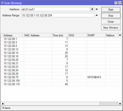

when i run Ip scan on Mynet-C, Mynet-B, Mynet-A router, they can detect 14 hosts.

ip scan from a mid-way router…

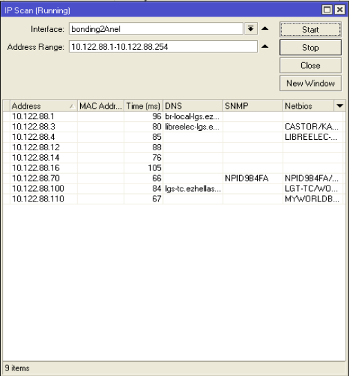

ip scan from last router..

Mynet-D CHR
on the cloud, can ping only 8/16 devices. Cannot ping computers and mobile phones. Can ping voip phones, nas hard disks, printers, etc..
