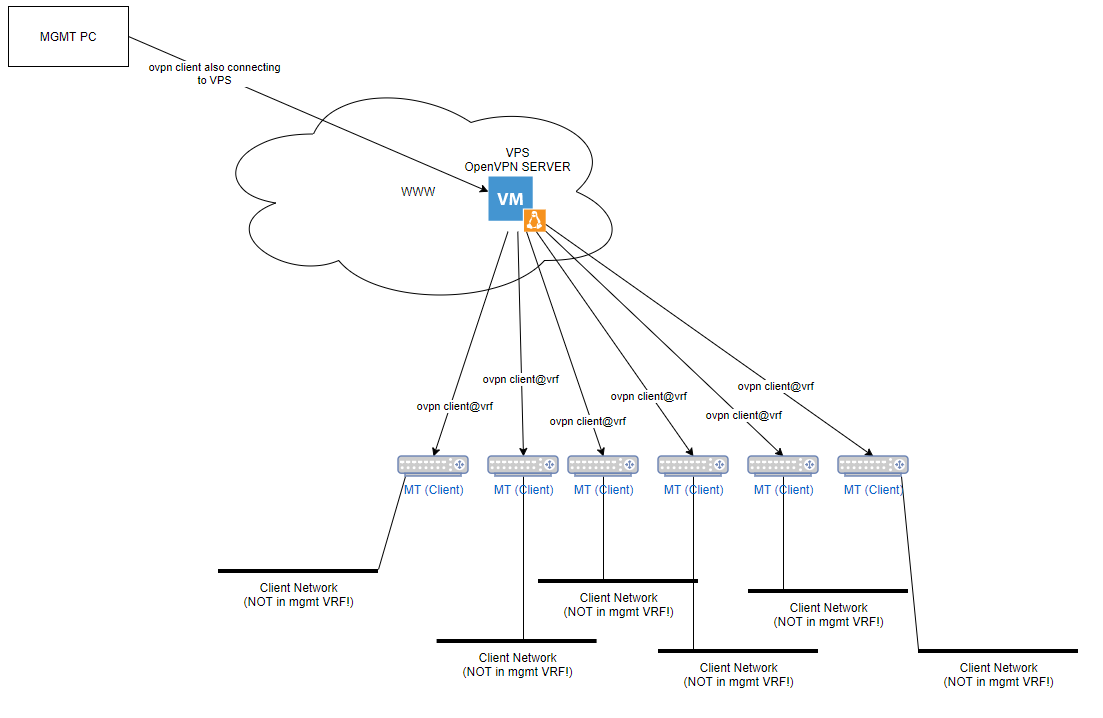

i guess the setup is something like this:
AFAIU the OP just wants to have the remote mgmt tunnel in its own “mgmt vrf” on the router

Yes, exactly what I would like to achieve! Thanks for your diagram. However I did not find any working solution for this.
I'm open to other options as well, but the "client" networks behind these routers usually include several subnets, sometimes even overlapping with my VPN subnet. That's why it would be ultimate if I can use a different VRF.
