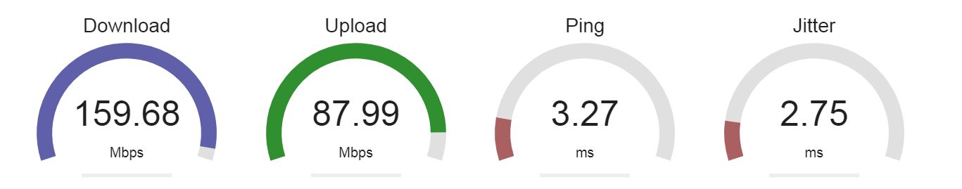

runing Omnitik AC since 2 months connected SXTqac on plain 802.11
link uptime 33days (reseted only because of wlan protocol change to 802.11)
my speedtest on 40mhz channel ( 360~400mbps PHY rate)
nv2/nstreme wouldn’t give me half of it.
