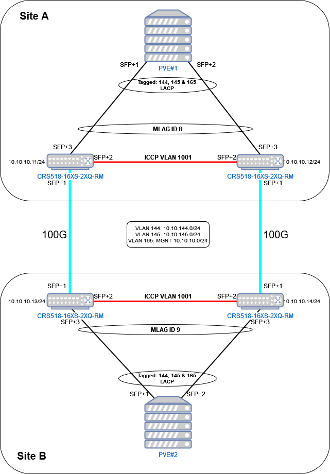

Hi there,
I have a question about a planned MLAG setup witch CRS518.
I would like to connect some PVE clusters that are located in two different locations.
Each node is connected to both switches on its side.
There should be two edge-disjoint dark fibre 100G connections from site to site.
Is my drawing correct? Can this be implemented with the MikroTik’s using MLAG? The examples in the documentation are not entirely applicable for this case.

The short answer to your question is that it should work and your diagram looks good.
I did a similar configuration in the core of my network, with two CRS317’s in one MLAG setup feeding six routers, and another MLAG pairing with a 312 and 354 feeding my home/office router (a 2116). Then I connected the two MLAG pairs to each other using LACP and it works great.
One thing is missing. You haven’t marked the blue links as a LAG with an MLAG ID (it can be the same for both sides if you like).
The blue links themselves are a LAG between the MLAG pairs. To the switches, they will need to be configured just like the links going to the PVE stacks.
Keep in mind that mlag is hopelessly broken on mikrotik.
I plan a similar Setup. One question about your picture: the blue and red connections are result in a loop, so one link is “alternate” right?
In MLAG setup, the interconnect between collaborating switches is not active/backup kind of link, it's ICCP link (see MLAG manual) which is always active and passes traffic between switches which wouldn't otherwise reach destination. For example: if server has a LACP connection to two MLAG-configured switches (server is not aware of MLAG, it uses LACP link as if all member links were connected to single switch) while client is simply connected to one of switches, then server might send out frames for client via "wrong" LACP link ... then ICCP link between switches is used to pass frame towards end destination. Which means that (depending on physical layout of all connected devices) a considerable portion of switched traffic may pass ICCP link and this, in turn, means that ICCP link has to be over a relatively very fast link.

i'm not sure, if it is correct. I have exact the same setup as the picture.
But the ICCP Link on Site B is "alternate" on the Bridge and as Root Bridge will be the MLAG ID on Site-A.
BTW: In the MLAG Documentation, they say that Hardware offloading must be disabled.
Do you know if this will happen automatically? Should i disable HW Offloading on the complete bridge or only the MLAG Uplinks or only the ICCP?

I dont’t understand what do you mean with “You haven’t marked the blue links as a LAG with an MLAG ID”.
The blue lines are normal interfaces (in this case sfp-sfplus1) without MLAG or LAG - right?

but one of the blue links is an alternate port?
The role of blue links depends on particular setup. If nothing special is done about them, then they are active/backup, handled by xSTP. If they are configured as LACP bonds (between both pair of MLAG-configured switches), then the way they are used depends on how switches operate ... but will likely be used in parallel (reducing need to pass huge amounts of traffic over both ICCP links).
Hi mkx,
now it's up and running. My mistake was not to use MLAG between the two Sites. I thought normal links are ok, but then one of the lines will be selected as alternate.
when i use mlag between the sites, all links are designated :sunglasses:
