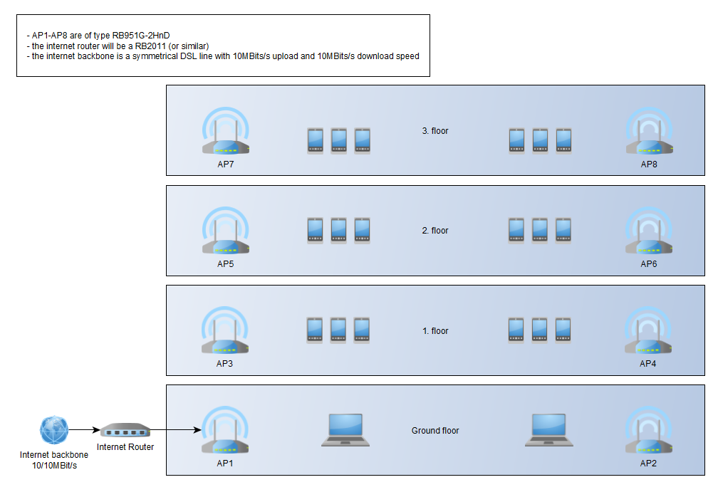

we have to make a very interesting offer to one of our clients who lives in a castle..
In his castle he is showing some audio streams and videos and other interesting informations about his castle to visitors (maybe 20 people per visit).
Now to the problem:
  • the visitors will use their smartphone to connect to the WLAN as they enter the castle on the ground floor and will then go along a specified route/path to view all the interesting stuff what’s exposed in some different rooms (not all the castle! just some parts of it).
  • the visitors will get a voucher and use it like an internet hotspot solution (they enter their credentials into the browser, a special landing page is opened an there are the hyperlinks for the different language streams)
  • since they are listening to audio streams (or maybe video if the bandwith should be enough..I don’t think so!) during the visit they have to roam between the accesspoints called AP1 to AP8. It really has to be a “true roaming” solution as the buffering is very short and otherwise they would just see timeouts and errors on their smartphones and our client would get angry.
  • the problem in this castle is the available infrastructure.. there are no network cables, just energy cables.. and clearly there is no possibility to lay a copper or fiber optic cable in this building.
  • using wireless hardware with 2 different radio modules would be nice but to expensive for this project.
  • the internet router will be connected by ethernet to the first AP (AP1)
  1. How could we make this project as a good working solution with roaming capabilities?
  2. Should we use the WDS capabilities of the accesspoints and mesh them all together? Have tried this in a Motel without success!
  3. What are you thinking about MPLS (so a routed and bridged network)?
I hope there is someone out there with some good ideas for us.. :wink:
Thank you very much in advance!

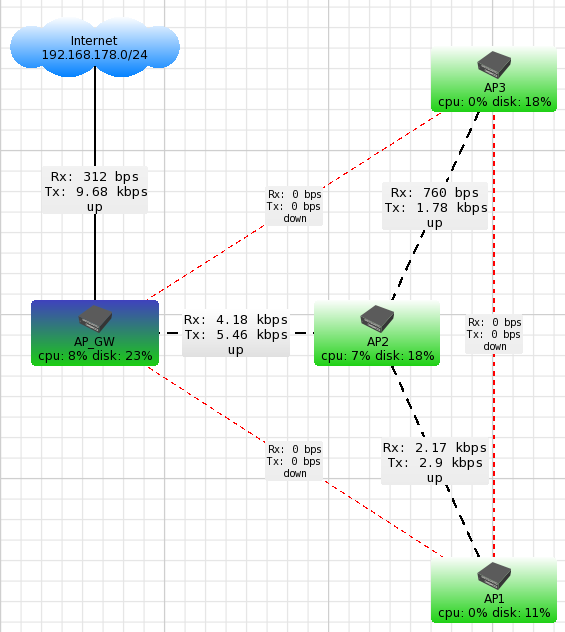

Then I have created new WDS interfaces from every device to every device. (see DUDE screenshot, ALL interfaces where UP - just an old screenshot!!)
So every AP is connected to every other AP via wireless WDS (no ethernet connection, just wireless!).

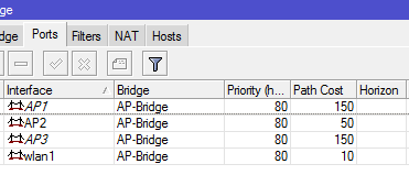

bridge configuration:
bridge name=AP Bridge
protocol mode=rstp
Then I have added all the WDS interfaces + the wlan1 interface to the bridge and set the path cost to have shortest (best performant) ways to every AP. (see screenshot)
On AP_GW, it is the main AP (called “accesspoint gateway”), I have set the STP priority to “1” as the RSTP tree should be build from there.
So AP_GW is the “Root Bridge”!

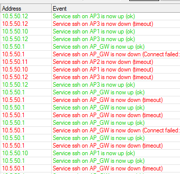

The system was running all the night with DUDE running on a testmachine.
BUT
i could see, the network was a lot of times offline and came back online after some seconds/minutes..
AND
Some of the accesspoints have restarted over night!? Why? (see screenshot)
