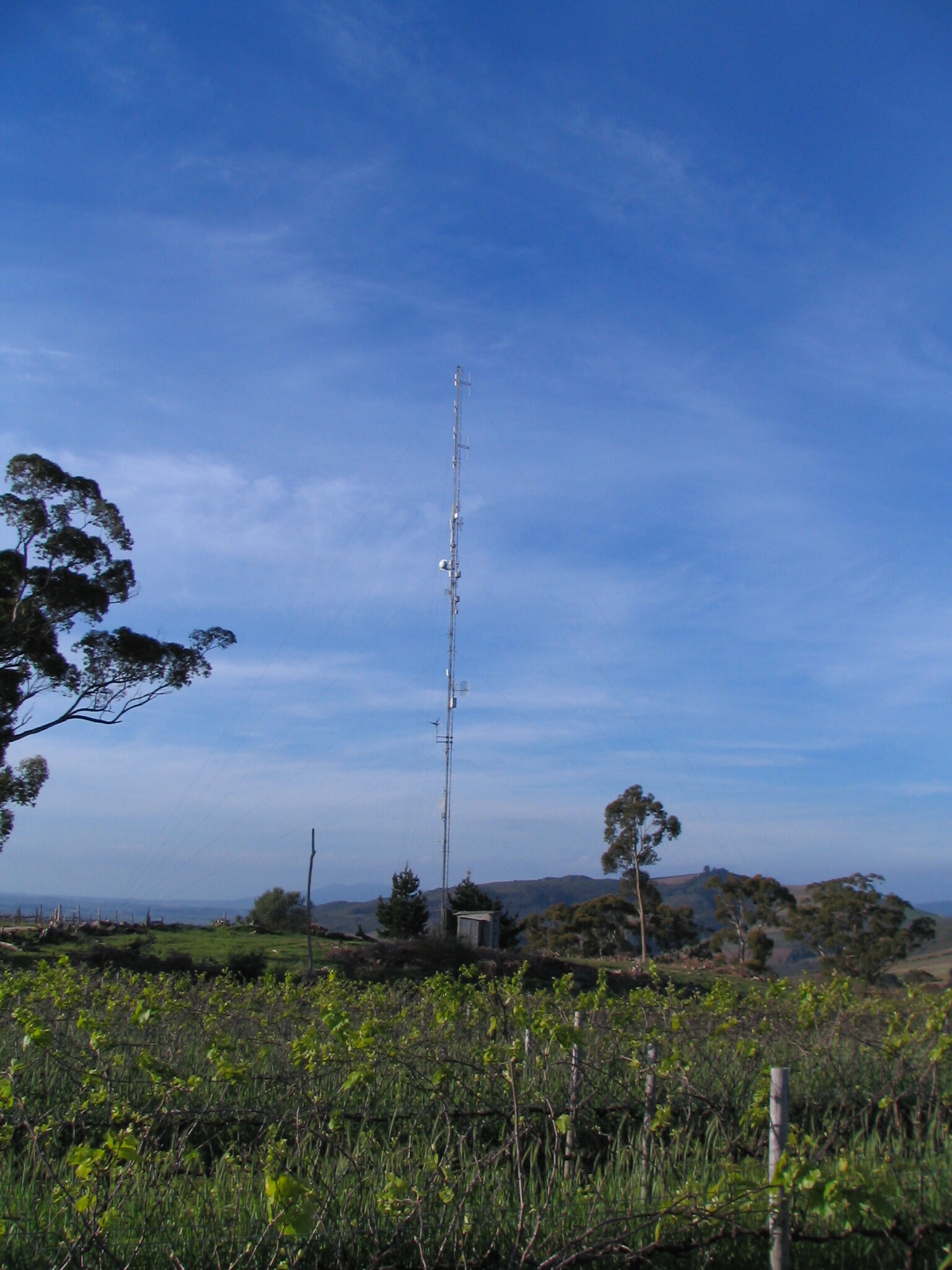

Yesterday I received my first consignment of routerboards with plastic RJ45 connectors.
Today, I’m supposed to mount one of those routerboards near the top of this mast.
You don’t have to be a rocket scientist to work out how high this mast is, just look at the 60cm UBNT dish that’s fitted with a radome.
This is typical of many of the masts that are used all over the world, 250mm wide, 30 - 40m high and held steady with stay wires.
These masts move. Not much, but they move in the wind. Especially in a place like Cape Town where there is a “Souteaster” blowing at an average of 50km/h for half the year and then a “Northwester” blowing at an average of 50km/h for the other half of the year.
How do we ensure that RJ45 connectors don’t come undone from the constant shaking up there? We solder them to the metal chassis on the connector. One blob of solder is all that it takes to secure a connector to a routerboard and to ensure that you don’t have to climb up that mast at 2:00am in a raging storm to go and seat a connector that’s shaken loose.
