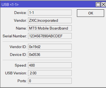

Add support for 4G usb-stick model 8810ft!
here is modem info
I have the same problem. Firmware 6.47
YOU must do a supout.rif file and send it to support@mikrotik.com.
We at forum are not a MikroTik developers… you must that stuff write to MikroTik.
Thanks, developers add support this modem in 6.48beta12
