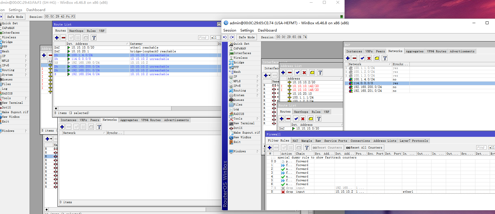

I scratched my head looking at this and decided to just test it in the lab myself. Whether or not I can reach the BGP routes is fully dependent on whether or not I have the static route (to 192.168.199.0/24 via 10.10.10.2) on ROS-01 enabled or not. At some level this makes sense to me because I imagine there is a single next-hop entry in the FIB and when check-gateway=ping decides that the next-hop is unreachable, this same conclusion carries over to every other route that has the same resolved next-hop. I think the behavior is consistent and in the big picture makes sense even if it’s a little unintuitive at first glance. I am having a hard time understanding the administrative purpose of caring about the reachability of the same next-hop via ICMP for some routes and via other means (ARP/recursion) for others.
On the other hand … from your screenshot it looks like the static route is disabled? Do you still have reachability issues when it’s disabled? For reference, I tested this with 6.49.2 because it’s what I already had in the lab and I noticed yours is 6.40.8. If you still have reachability issues when the static route is disabled, there may be some bug fixed in the intervening four years of releases where disabling a static route with ICMP next-hop checking forgets to go back and reevaluate the next-hop status in the FIB based on ARP/recursion. I’m not gonna skim through all of those patch notes but at least we know that it behaves correctly on later releases :slight_smile:

When I tested these two ROS versions, the fault phenomenon was as follows:
ROS-01 added a static route, the next hop of this static route was the ip address of the Ether1 interface of ROS-02, and Check-gateway was set =ping, when the ip address of the Ether1 interface of ROS-02 discards icmp packets, the static route added by ROS-01 will be unreachable. (This must be a normal and reasonable phenomenon), but this static route appears When the unreachable phenomenon occurs, the BGP route received by ROS-01 from ROS-02 is also unreachable. At this time, when the static route Check-gateway of ROS-01 is disabled, the static route and BGP return to normal. I don’t know.
