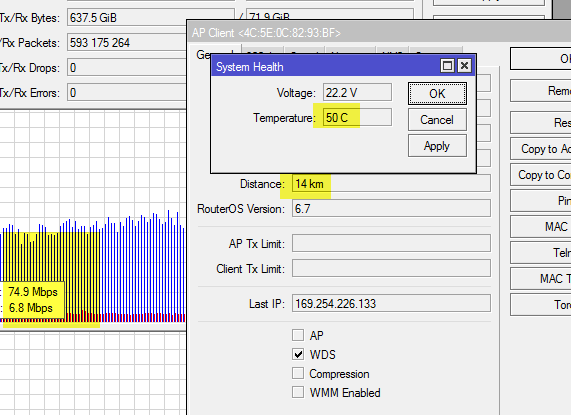

its easy sir just 32db with Rb912 its ok and more
look to this link
it’s 30 MBps (MegaByte/ps)
