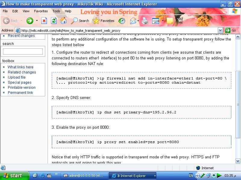

To cache downloads, you need web-proxy. See
http://wiki.mikrotik.com/wiki/How_to_make_transparent_web_proxy
i do it but the download is normal

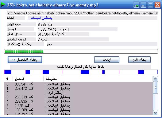

i want download speed as the speed in picture
i follow this site but the download in normal
proxy will not improve speed. proxy will cache popular files, and once somebody else requests the same file, it will be taken from cache, instead of the internet. this may not work if you use download accelerators which split files in parts.
