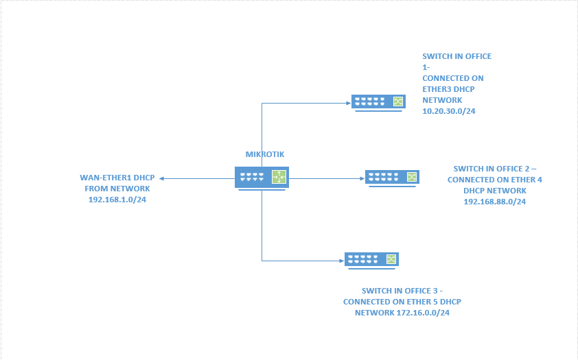

Hi , I have attached the map of the Network below, I want to be able to connect to any of the 3 switches and reach all the other subnets on the Mikrotik , the Mikrotik is the only router in the design.
IP Forwarding is enabled , but there is still no routing between the subnets
cant access your image, instead of placing an image, attach the image as a file attachment, scroll further down when creating the post
Attached
Nope, doesn’t help anything, nothing special there, from IP Diagram I can’t see why it will not work and should just work.
