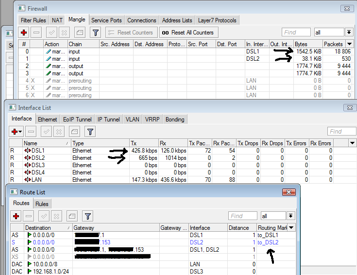

i already made ECMP load balancing with masquerade , but as you see in attach screen shot i tried now with two DSL lines , one of them have the big traffic and the other one almost haven’t traffic , and also i can see this on the other DSL2 router , because the activity led not like on the DSL1
please decide whether you use Nth or ECMP. with ECMP you should only have 1 default route. just disable you 1st and 2nd routes

/ ip route
add dst-address=0.0.0.0/0 gateway=10.111.0.1,10.112.0.1 check-gateway=ping
I can’t see all your other static routes in Wiki example…
