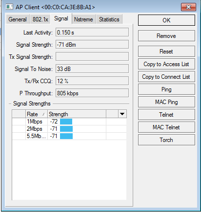

Please help rb433ah +xr2
I do not know where is the problem
Image at the bottom
ap bridge
mod b
add route to next machine so that signal data is exchanged properly.
Interference? what is the noise floor?
he has already said, -71 + 33dB = noise floor of -104dB

Excellent Signal and Bandwidth bad
Citing an excellent person, but browsing has very bad

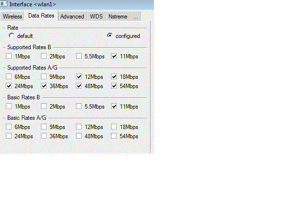

Now mode g Only
Situation has improved little
data retas
Photo attached
If you choose to
1 mb 2 mb 5.5 mb
Gets worse near the transmitter and an excellent reference, but data transmission is bad
What is the best preparation data retas for 2.4 mode g channel 1
For data-rates i would recommend using 1Mb for 802.11b, and 6,18,24 for 802.11g.

My question is easy
Why when I activate the 1 mb 2 mb 5.5 mb In data retas
Become bad
Why does not my channel width
What is the problem
It´s normal, please read about what is OFDM, DSSS, CCK and how it works.
In a more simply way, OFDM works with sub-carriers instead of only one big carrier, so your system will have higher chance to receive some of them. This means that you will have higher ccq on 802.11g.
Best regards,
buddy how much bandwidth r u distributing to ur clients
if u enable data rates u r putting a cap to that. since links r usually half duplex CPE’s u will get throughput of only half the data rates.
divide the thruput with the number of clients u have. that is the actual thruput u r leaving for 1 client.
Enabling data rates is not advisable for Point to multi point links.
I guess ur latency must be going very high whn enabling data rates
