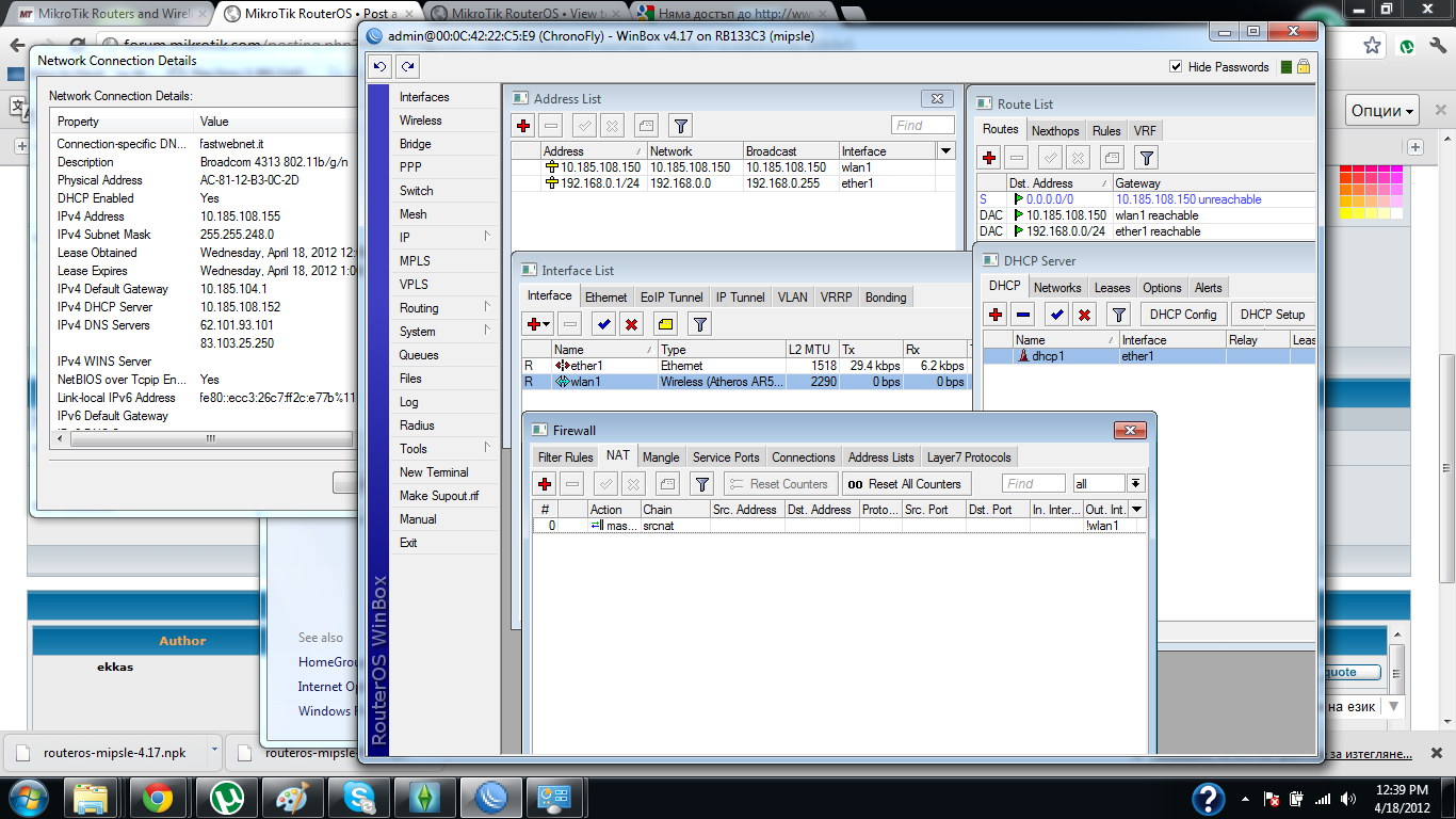

Please help whit routerboard 133c
cant make mu station mode work corect
i am connected to network ut cant make it to use internet from cable
help me pls
your default route is blu: the gateweay is not reachable or you have another default route?
nop in don’t have and that’s why I’m posting here. I don’t have basic networking skills and don’t know how to configure
if anyone know step by step tutorials will be very helpful. ty
remove this ip 10.185.108.150 and then add it again and type in the address 10.185.108.150/24 and select your wlan1
then fix your gateway because your gateway is the same as ur ip as seen in the pic
