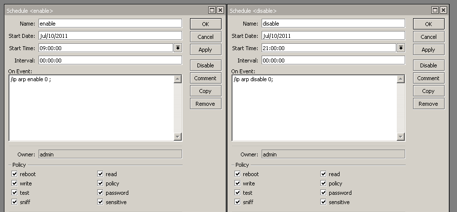

Here is an example:
Hi again.
This is what I’ve been trying and nothing would happen:
You can’t use item numbers in scripts.
/ip arp { disable [find comment="emachine-wifi"] };
Schedule that to run at night, then schedule an enable version to run in the morning.
Thank you sooooo much! The problem is solved.
Now I understand the syntax well.
I think this topic will help other users too, for its simplicity.
Hello, there is still a problem:
The script didn’t run on the schedule, here is a screenshot:\
Thanks for ur help//
It will run exactly as scheduled, in -41.5 years.
Ohhhh hahahahahaha…
I thought the start date wasn’t important in my case…
