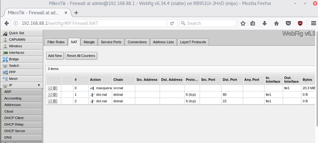

Here is what I have configured:
[admin@MikroTik] > /ip firewall nat export
apr/13/2017 14:01:52 by RouterOS 6.34.4
software id = 3FPY-TT1R
add action=masquerade chain=srcnat out-interface=lte1
add action=dst-nat chain=dstnat dst-port=80 in-interface=lte1 log=yes
protocol=tcp to-addresses=192.168.88.254 to-ports=80
add action=dst-nat chain=dstnat dst-port=22 in-interface=lte1 log=yes
protocol=tcp to-addresses=192.168.88.254 to-ports=22
[admin@MikroTik] >

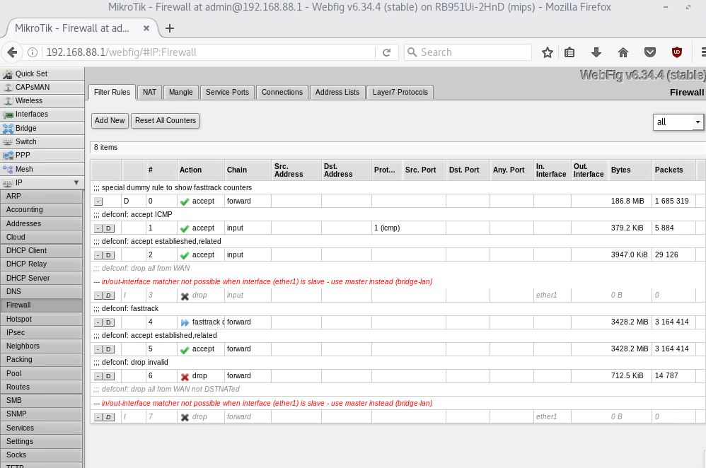

[admin@MikroTik] > /ip firewall filter export
apr/13/2017 14:12:35 by RouterOS 6.34.4
add chain=input comment=“defconf: accept ICMP” protocol=icmp
add chain=input comment=“defconf: accept establieshed,related”
in/out-interface matcher not possible when interface (ether1) is slave - use m
ster instead (bridge-lan)
add action=drop chain=input comment=“defconf: drop all from WAN”
in-interface=ether1
add action=fasttrack-connection chain=forward comment=“defconf: fasttrack”
add chain=forward comment=“defconf: accept established,related”
connection-state=established,related,new
add action=drop chain=forward comment=“defconf: drop invalid”
connection-state=invalid
“defconf: drop all from WAN not DSTNATed” connection-nat-state=!dstnat
connection-state=new in-interface=ether1
add chain=forward connection-nat-state=dstnat log=yes

little mess in forward chain. Try temporary to disable all rules in forward and test again (use safe mode) . nat rules is ok

In your dst-nat rules remove the in-interface as lte1
Go to IP>Cloud and enable it, allow it to update and copy the host name.
Go to IP>Firewall>Address-Lists and create a new address list called dynamic-IP and enter the host name into the address field, recent rOS will resolve the host name dynamically and create an entry with a “D” before it
Go to your dst-nat rule and click into “advanced” and use the “destination address list” drop down and set it to the “dynamic-IP” address list you have created.
