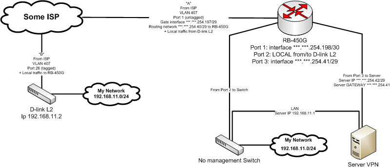

Please help with RB-450G. Need configure board with tag VLAN
I have RB-450G and i don’t know how configured them.
On a picture see:
My ISP give me 2 channel with VLAN 407
On channel A:
port 1 untagged, need create them tagged.
what i can do?
where i create VLAN
  1. I am check Use Service Tag,
  2. create interface to VLAN 407 with ip ..254.198/30
  3. add static route 0.0.0.0/0 → ..254.197
  4. ping ..254.197 is OK, but where traceroute to some internet ip, trace on gateway ip stoping
port 2 untagged, how use LOCAL NETWORK from channel 2???
i am on port 2 create master port 1 and use local network from chennel 2, but I wish to have possibilit use VLAN on this port, without master port.
on port 3 create interface ..254.41/29 (net ..254.40/29) but where create vlan id 40 and include interface to this VLAN i can ping only interface ip and can’t ping server ip ..254.42. why?
Please help configure RB-450G… how illustrated on picture.

so, vlan 407 is you vlan or your ISP made it for you?.. “untagged vlan 407” sounds a bit crazy…
Yes it’s a bit crazy ))) port 1 on Mikrotik need use as tagged
and vlan 407 made my ISP

“Use Service Tag” works for you? so, 407 is QinQ vlan?.. it should be unchecked for ordinary VLANs…
